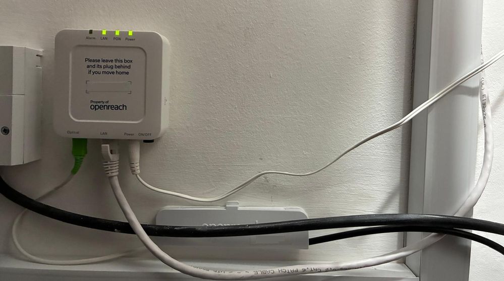

Could you post a picture of your CSP / ONT install for future reference when we try and help others? Thanks.

My CSP and ONT:
The CSP cover is struggling a bit because of the ingress angle of the fibre because of the trunking!

As to the install itself that does not look at all. I would consider the incoming fibre cable to by vunlerable. You can complain about the install on the OR website and you might get someone out to look a it.
