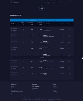

I upgraded to Screenshot_11-3-2025_8811_www.speedtest.net.jpeg 500 last week and my speeds are consistently way below, around 50mbps download speed, this is now slower than what I upgraded from! What could be the problem?

@mpsoborne what product were yo on previously,  with whom, and how are you measuring your speeds - wireless or wired?

Plusnet Unlimited Fibre Extra was my previous package. I'm checking speed using wirelessly, I don't have a spare ethernet cable. Nothing else in the house is currently using broadband.

To isolate this problem you really need to get a wired connection to the router to test with.
Currently you have two potential problem areas: the connection between your router and Plusnet, and the WiFi signal within your home.
@mpsoborne if @jab1 s suggestion dosent give any results
you need to make sure that the device is connecting to the 5ghz band. A 50Mb speed looks remarkably like its connected to the 2.4ghz band in which case 50Mb is about what you'll get!

Looks like it is using 2.4ghz band, how do I change it to 5ghz ? will this affect anything else? Thank you.

@mpsoborne  assuming the laptop is running Windows , https://www.thewindowsclub.com/how-to-force-wifi-to-connect-over-5ghz-in-windows-11-10
It wont affect anything else

Have managed to change laptop to 5ghz, checked speed using plusnet speedcheck now getting around 90mbps, still long way off 500
