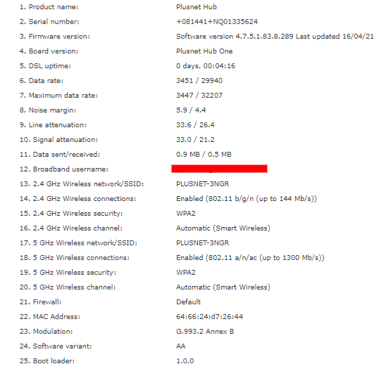

I reset the router to factory settings and did the above again, out of interest

@WotW The sync speed has dropped a bit but still close to 30Mbps, maybe it is not banded only Plusnet can check that out. So are you saying that the openreach guy/gal plugged your router cable from the phone socket into his tester and got 38Mbps? The test kit is basically a modem with a display and software to run built in tests so it may just be that the test unit modem is better than a Hub1 (which wouldn't surprise me) and syncs at a higher speed. Or your Hub1 could be faulty.
I would suggest a BT HH6 would be a better way to go as it has a better modem chip and Wi-Fi.
You really need to get Plusnet to respond following the engineer visit.
It would appear from your upload speed profile you are on Fibre Extra, I don't think your line can ever achieve speeds above 40Mbps download so you could possibly save a bit by downgrading to Unlimited Fibre, depending on your contract situation of course.
Just seen your post with the Broadband Checker result, all I can say is it doesn't look like it's for your line, observed speeds with today's date of 33Mbps Down and 9.25Mbps up do not tally with your router stats and the estimated speeds seem higher than I would expect for a fairly long line. So something very odd going on there. Need help from customer support.

Yes, to the scenerio you suggest.
Yes I wondered re. the fibre extra, as me last year has been that contract (I think) but, tbh, I'm paying £21 a month, I can get lower, but not by much and PN seems to be proactive and friendly - which is rare now a days!
Hopefully customer support sees this, I'll call up if not - I'm not in a massive hurry
