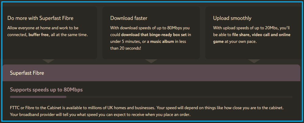

I have just checked my postcode, and Openreach tells me I should be able to get superfast fibre. I notice it says 'up to 80Mps', and I can only get 30Mps at top of my range.

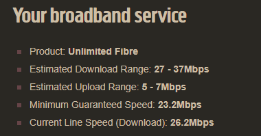

@WotW  There is a chance you have a static WAN IP address, you may not have asked Plusnet for one but in some cases they will put you on one without telling you. This means your connection uses different Plusnet network equipment and your speed can be capped by Plusnet's "Current Line Speed" which is a profile that controls your maximum throughput speed.
You can check the Current Line Speed in your member centre account under the Broadband tab, it may be nothing to do with your problem but worth having a look.

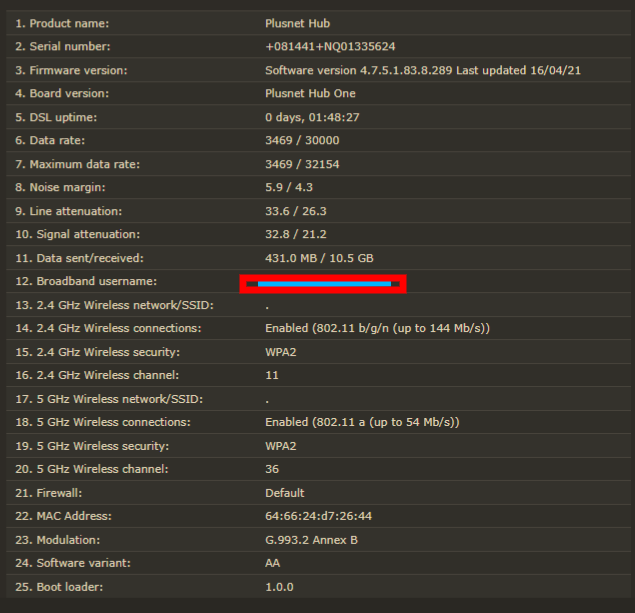

It would be worth knowing your modem sync speed which is displayed in router diagnostics (Help Desk on Hub1), not sure which modem/router you are using.
WotW
Posts: 28
Thanks: 3
Registered: ‎14-04-2021
Re: First world problems, my speed at the low end of the range - £20p/m for 20mps
WotW
Posts: 28
Thanks: 3
Hi RealAleMadrid,
Thank you for information. Could be!  The openreach guy couldn't understand why the router would be dropping the signal so much. He asked if it was an old router...its one year old

@WotW  From the information you have given it looks like your sync speed is the main problem it is exactly 30Mbps which is suspicious and usually means the line is banded at that speed, the odd thing is the Openreach operative (they are not engineers in my opinion 🙄) claimed to get 38Mbps but I don't know how this was tested.
You need to ask Plusnet for a GEA test which should show if the line is banded although the Profile info can be a bit out date, they may have other ways of finding the current active profile.
A test you could try is a single restart of the Hub1 if the sync speed is still exactly 30Mbps that would confirm the banding.

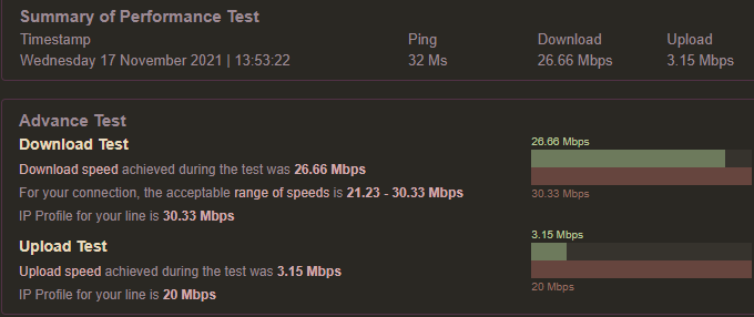

WotW
Posts: 28
Thanks: 3
That is after a restart.
Hmm, I wonder. From what he said it seemed like the signal was 38Mps from the Openreach socket, then he went to the router and plugged in the dsl cable (that is usually plugged into the router) and again measured 38Mps.
But everything from the router is under 30Mps, plugged directly into the router or not
