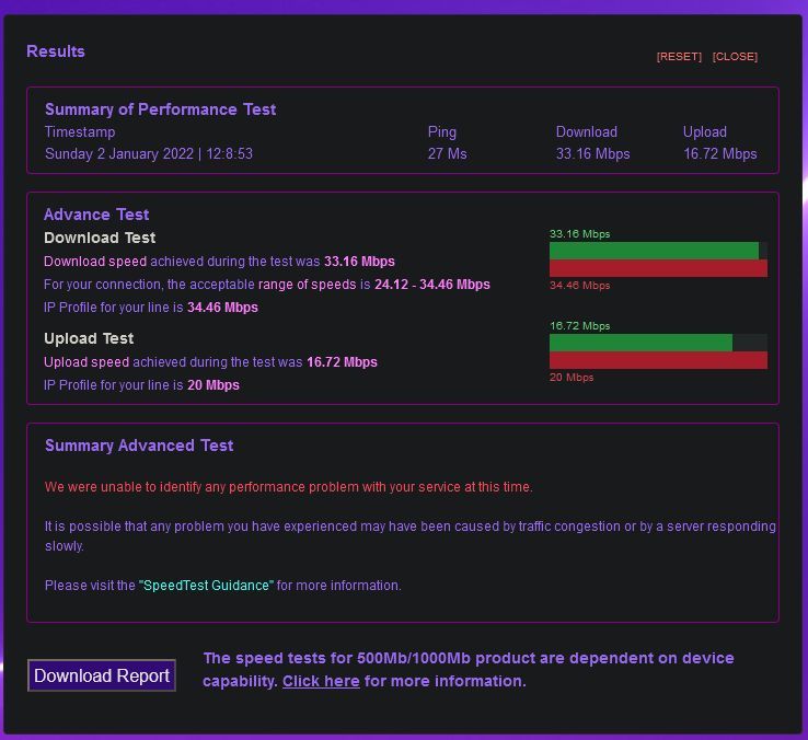

My estimated speed is 56-71 mbps, with a guaranteed minimum of 50mbps. It has felt slow this week & so today I have performed multiple speed tests & am only getting around 33mbps. Nothing has changed at our end.

Re: Fibre unlimited speed halved in the last few days
02-01-2022 12:22 PM
02-01-2022 12:57 PM
I decided to try a quiet line test. and there was definite buzzing / phasing on the line. I then noticed there were christmas lights running very near the socket - started moving them about & the noise changed. Switched them off & the line was much quieter.
Have we been training the DSLAM that our line is poor for the last two weeks?
Is there a way to reset it? Will the speed eventually return to what it was now the intereference has been removed?
02-01-2022 1:31 PM
As long as the line has not been banded then it will slowly recover. You need to leave it for a week or so and see if it improves.
Plusnet can only request a reset if it has been banded.

What you need is a friendly Plusnet staffer to come along and either check or show us the results of a GEA Test.
02-01-2022 7:49 PM
Hey @jan,
I'm sorry to hear that you've been having issues with the connection lately. I've just run a speedtest and whilst I can see the line is banded at 60Mbps, the current downstream sync speed is showing up as 35.6Mbps. Have you still got those Christmas lights setup near the router at the moment, or have they been relocated/taken down? If they're still plugged in or nearby the router, it may be worth removing them from the equation and giving the line a couple of days to see if it gradually returns the usual performance. If at that point it doesn't and the speed is still low, we may need to look at getting an engineer round to take further look.
