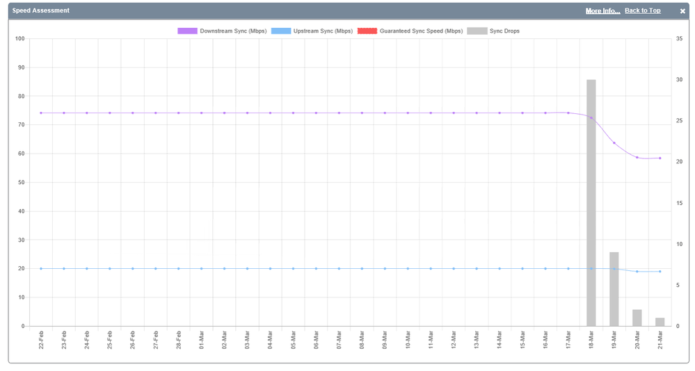

Hello @StevieR1, thanks a lot for getting in touch and I'm really sorry to hear that you're still having issues with your broadband speed, despite the phone fault being resolved. An RRT line test on my side is still showing line issues, and a large reduction in sync speed which to me, indicates that there's still an underlying problem with the line, despite the figures on BT's Availability Checker changing.
Going forward, I've updated the open fault ticket, requesting you to respond with dates that you'd be available for an engineer visit. Give me a nudge on here once you've responded and I'll get the fault raised.

Thank you @adam945 for this reply and the graph showing the drop.
The speed has gone up a bit to around 41-55Mbps at times but still way below what it was before Friday and my gaming pings have also doubled to just over 40ms Sad
I have responded to the ticket to move this forward now.
