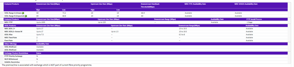

Can you also check the Openreach estimates for their line to your house at:
Please post the results on this thread after removing your phone number.

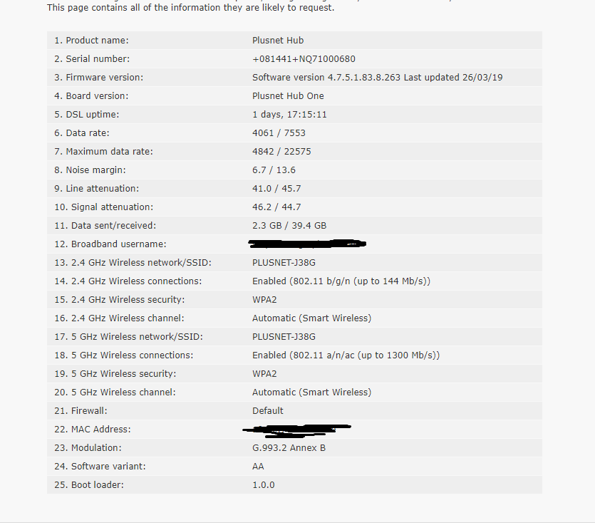

Can you please check the connection speed of the router?
If you are using a Plusnet Hub one router, the connection data can be found at: http://192.168.1.254, then click troubleshooting and then help desk.
Please post the results on this thread, after removing any WiFi related information.

Hi, thanks for the reply. I've always used a computer + eth cable for the near 4 years I've had plusnet fibre.. last time I speed checked I had 70 down 20 up. Heres what I've got: 326359ea1acfbe22d0788584dd18b23d.pngf4ca3953aa9ff5184a0c8fca8fc7fa04.png

Yuck!
Something is badly wrong with the router speed figures, they are significantly below the speed estimates for the line to your house.
I suggest you log a fault with Plusnet.

The router is repoting a line attenuation (41dB) that if correct will never support the BT speed estimates (70 mbps).
