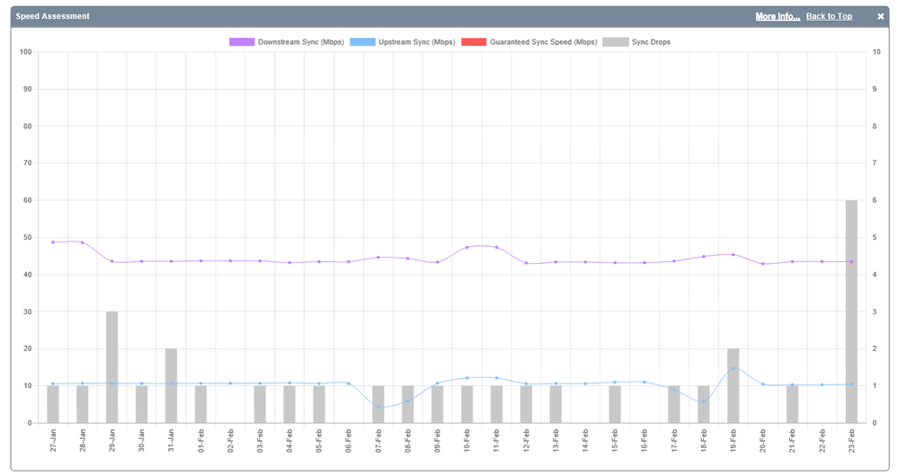

Thanks a lot for getting back to us @Sselby123 and I'm really sorry to hear that your services have not imp[roved. I've tested the line again this morning and it does appear that speeds are now coming through  at 45.0 Mbps. I can't go as far back as December on the RRT, but it does show fluctuating speeds and numerous disconnections.
Going forward, we theoretically could arrange another engineer visit, maybe another engineer can spot something that the previous one didn't, however if this issue is being caused by a wider Openreach infrastructure issue, it might be a case of hanging fire until they're able to resolve it. Speeds are currently just above your MGS at the moment.
