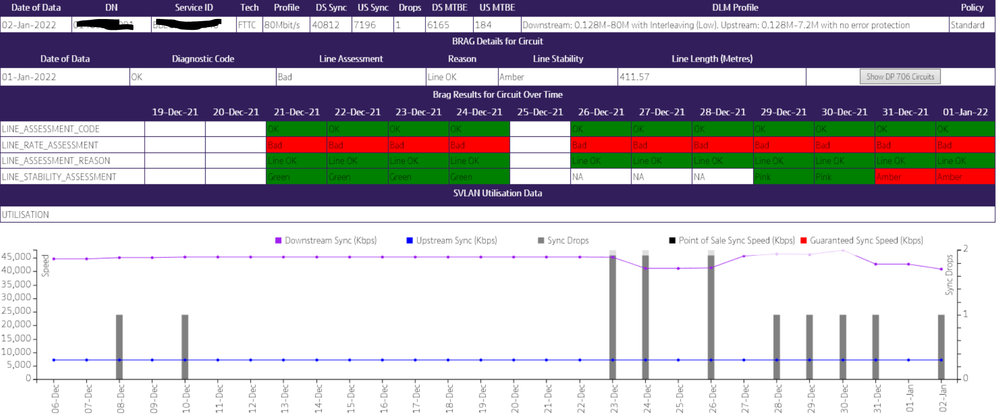

No faults found on the phone line apparently, and I can say the internal wires are all new as I brought them new with the new hub I set up on 30th dec. There is something going on and I would like it fixed. I will be calling customer service on Wednesday (48hrs use in test socket)

Thank you @RealAleMadrid - I'd overlooked the fact hat the OP's upstream speed has been banded.
@jab1 I do understand where you're coming from in terms of  raising a phone fault, though we'd raise a broadband fault in this scenario, as tests aren't picking up on any issues with the phone service, whereas the OP's speeds and drops do look suspicious. No one is denying an issue with the line as it stands, though it's process to ask customers to carry out their own checks through their test socket before raising the matter with Openreach, especially when tests aren't picking up anything.
I'll stick to what I said before, to see how the connection fairs over the next 48 hours through the test socket, even though an RRT clearly shows fluctuating speeds and drops. If these don't improve, well definitely get a fault raised.
Going back to the banded upstream speed as well, the engineer should rectify this is booked in, if not, we'll raise it on our end.
No need to contact customer services @Sselby123, you can let us know on here and we'll get it raised. Smiley

Well engineer has been and gone, he checked phone line all clear, he did further testing that he didnt need too, and found I can only get 50mps to my home and I lose a small amount of speed from exchange to master socket. He checked my DSL line which checked fine. So given the fact I can only get max of 50mps I'm currently paying for a package I cannot get!. I will be paying very close attention to any dropouts now as it will be a broadband issue. Also he checked my master socket and there is no fault there either.

Sight of the router stats would be interesting.
Do not confuse no fault found at time of engineer visit with there being no fault whatsoever.  If the DLM is managing the line speed, it will be doing so for a reason.
Does the router you use lend itself to being monitored with something like routerstats?  See the link below.

The Plusnet Hub One is a rebadged BT HH5a for which there is a special version of RouterStats.
Running that 24x7 might shine some light on what is happening on the line.

I've tested your line and the tests aren't showing any issues now with your connection staying stable since the visit.
Appreciate though your speeds around 5mbps below where we'd expect of between 55mbps to 74.3mbps as shown Here, they're above the minimum guaranteed still we've agreed when you signed up.
