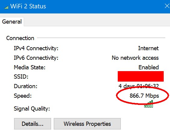

If you have a windows laptop in same room as the hub, what does Wireless properties show for 'speed'?
See example image.
Can you confirm you have Full Fibre 74 where there Hub 2 connects into the Openreach ONT box.
