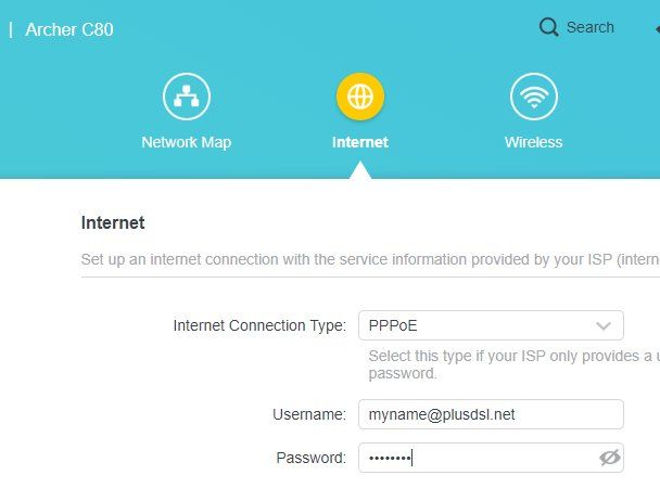

fwiw, as you have FTTP, and I presume the C80 is currently next to the hub 2, you could consider removing the hub 2 and connect the c80 to the Openreach ONT.
Use the C80 in regular 'router mode', and plug it into the Openreach ONT.  Simply set up the C80 for PPPoE connection and enter your plusnet username which is in the format: 'myname@plusdsl.net', and corresponding password.

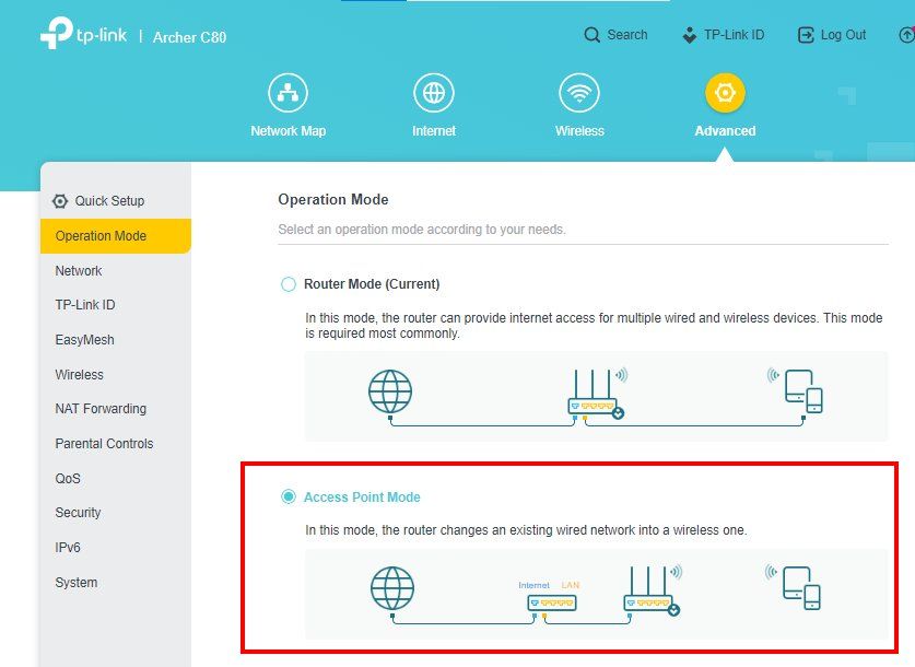

and put the fibre Hub 2 into modem mode
@bill888 the C80 must already be in router mode, because in modem mode the Hub 2 isnt making a PPPoE connection. In reality when used in modem mode in this scenario it's really only acting as bridge (network switch) between its LAN port and WAN port . In fact I'm sort of surprised that its modem (bridge) mode does actually work in this configuration

@MisterW I did wonder whether the @arts-and-crafts  was really using hub 2 in 'bridge' mode, and like yourself, surprised it would even work if true.
For that reason, I decided to post the info about PPPoE for TPlink anyway, just in case the OP had simply turned off the wifi on the hub 2, and is using the C80 in Access Point mode.
Hopefully @arts-and-crafts will confirm the operating modes of both the hub 2 and c80 for the currently working setup.

I accessed the Hub 2 admin dashboard and turned on Bridging in the advanced settings > broadband > routing > enable bridging. We connected the TPlink router with an ethernet cable from the Hub 2 into the WAN port on the TPlink. In the admin app for the TPlink we followed the settings for fibre https://www.plus.net/help/broadband/broadband-connection-settings/. We only had to make sure that 'PPPoE Always On' was set on the TPlink, and add the account username and password. It didn't need any of the other settings. The light on the Hub 2 turned pink, and we set up the TPlink to be 5G & 2.4G, named the network and set a new password. And then there was lots of lovely internet Except for the iMac, which is now connected by a very long ethernet cable from the TPlink.
