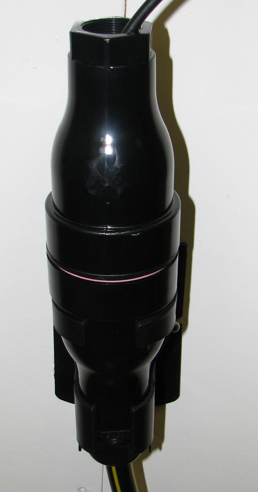

If you are in a similar situation then look at the pole which supplies your copper telephone cable and check for a black, roughly cylindrical, manifold which should have been fitted to the end of the black with yellow stripes fibre cable which runs up the pole.

The main body of the fibre cables are black with 1 or 2 thin yellow stripes running down them, so it may be possible that you can't see the yellow stripe depending on the orientation of the cable. Like this
The manifolds are about 1ft long and look like this
HTH  Smiley
