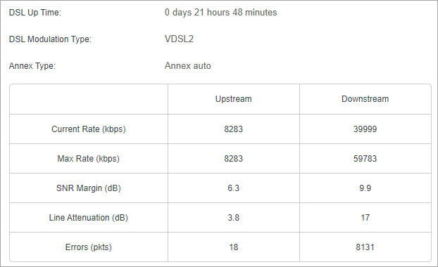

OP here. These are the stats the day after the DLM reset. I wonder (not) what the trajectory can be?
The downstream errors seem a little high. 😀

02-12-2021 10:53 AM
Hi Pete,
From your router's stats, looks like you're getting the full upload speed capable from your line of 8.2mbps and the full download speed capable of your package of 40mbps. If you upgrade to fibre extra, in theory you should be able to get up to 59mbps. Though I can't guarantee this as the supplier expectations for your line are between 35mbps to 47mbps.
Re: FTTC Speed 23Mbps, paying for 40Mbps!
02-12-2021 10:59 AM
@Gandalf Thank you. Yes, that seems to be the case today. However, forgive my ignorance, but 8131 downstream packet errors in 21 hours since the DLM reset sounds quite high to me. Compare it to the stats in the first post in this thread, where I had zero errors in around 2 days up time.
So, although today is still nominally high sync speed, if what I've learned through the earlier replies has stuck, DLM will see the high error rate and dial the sync speed down.
Which is why my expectation is that it will drift back to what I was getting before. Because nothing has really changed.
However, I do appreciate that your options are limited if the issue is just bad copper between the cabinet and my house.
As previously clarified, the copper comes across to my house from the pole, down through my garage, through the wall into a Mast Socket 5C, and there are no phone extensions at all.
02-12-2021 1:43 PM
Thanks for getting back to me Pete,
No problem, upon further investigation, line tests agree with you as they're showing "Downstream ES and SES have exceeded threshold from real time check. Continue submitting trouble report."
ES is Errored Seconds and SES is Severely Errored Seconds. Exceeding threshold from real time check means that when running a line test, at that moment, the errors are way above the norm.
I can see we've passed the fault back to our suppliers this morning and we're waiting for an update. I suspect it'll come to arranging another engineer visit to take a closer look. We'll update you as soon as we know more.
Feel free to let us know here how it goes over the next 24-48 hours though.
