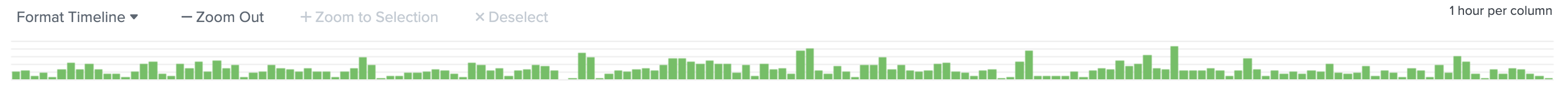

The first attached graph isn't the best, but it shows number of disconnects/reconnections per hour for the last week for customers connected to the same device in Chesterfield as @longedge
The 2nd graph is the same as me.
Quite clear that customers on the same device as @longedge are/were having a problem. There may be others, I'll check other examples shortly. Nothing showing since Friday though, anyone had issues over the weekend?
