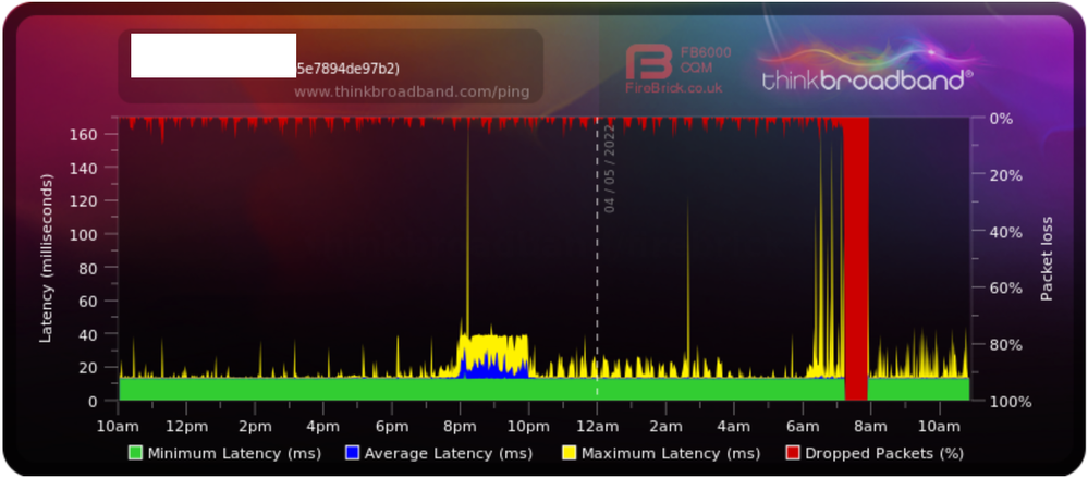

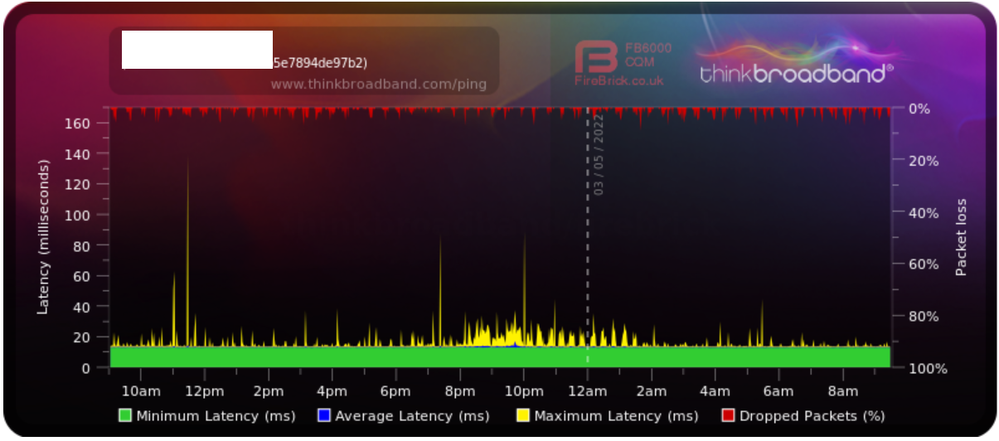

As subject - since approximately 2:00 pm on 25/4/22 I've been seeing packet loss 24/7 on my FTTP (trial) connection.
Not a major problem but something seems to need looking at to eliminate this new 'feature' on my TBB BQM graphs.
Neither graph below includes any heavy downloading which sometimes does result in some packet loss; present activity is just background stuff, including many browser tabs open, but that doesn't normally result in packet loss.
I'm on a static IP if that's relevant (which I wish to keep).
First image below is todays, showing said packet loss, below that is what it normally looks like.
I can provide the live BQM link by PM if required.
EDIT: My router has been rebooted a few times and I've even rebooted the ONT

It's probably not a coincidence that following my post above, after 8 days of constant packet loss it has now stopped.  I presume someone from the PN team intervened, so a big "thank you" to whoever that was.
This morning at about 7:30 my Internet wasn't connected so I assumed something was being done, and although the lights on the ONT looked normal I decided to reboot it.  After a few minutes I realised whatever had been done had confused my router which normally reconnects automatically, so after rebooting it all was well.
It'd be interesting to know what the problem was.
I hope I'm not speaking too soon, but here's a screenshot of todays BQM graph showing no packet loss since reconnecting.
I'm not sure what the activity is between 20:00 and 22:00 which seems to be a fairly regular occurrence recently.  I don't think it's caused by usage on my connection, so perhaps contention kicking in due to a heavy user on the same splitter as me, or a hot VLAN?  I'll watch out for that disappearing now the dropped packets issue has been fixed.

I appreciate my connection wasn't completely broken, but is there anything by way of test results or logs to distinguish any differences in the status of my connection before and after approximately 7:15 this morning when the BQM graph in post #2 shows my connection was interrupted?
