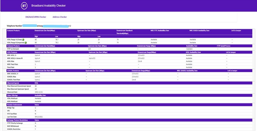

First things first - Can you post screen shots of (1) the results from BT Broadband (ensuring your phone number doesn't show) and (2) the 'Additional Diagnostics' from BTW Performance Tester ?

OK. From the Availability Checker you have posted, you are some distance from the cab, so speeds wil be on the low side - although the data on that shot suggests otherwise, I suspect it is not accurate.

Re: Cancelling contract due to rubbish connection
@jab1
I don't know if I'm missing something but the post and results above indicate to me that the OP is on FTTC and getting the full 80/20.
I suspect a wireless problem.
Posts: 17,508
Thanks: 7,104
Fixes: 491
Well perhaps not the full 80/20 since ' am on unlimited fibre '
but with those estimates it should easily be giving a rock solid 40/10
I'm with @Baldrick1 here, its likely a wireless problem...
@MisterW
Fair cop! I was just quoting the ADSL checker observed speed with it fixed in my head to get the message over that it is highly unlikely that this is a BT network problem.
@Baldrick1  / @MisterW - Sorry, but if you look at the ADSL speeds, it suggests to me that the cab(s) are some way away, and that observed speed is a bit like mine - told me I was getting 80/19 when I'm only on a 40/10 product, hence I treat them with scepticism, and is why I asked the OP for some hub details, before I passed further comment.
But if you want to take over, be my guests.
Posts: 17,508
Thanks: 7,104
Fixes: 491
@jab1 John, the ADSL speed estimates are based on the distance to the exchange not the cabinet.
I have a theory about the observed speeds... As you say , they dont appear to make sense when on a 40/10 product.
My theory is that they are not ' maximum observed speeds' but rather 'observed maximum speeds' i.e they are the estimated maximum speed, calculated from the actual observed speed and noise margin.
and , you are correct, that would be useful

If it helps , The DSL stats on the W9970 can be accessed from the 'Status' link at the top of the Menu when logged into the GUI.
It looks something like this
