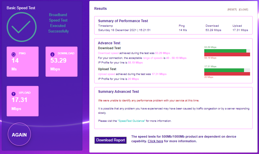

Here's the folks stats. The BTW test was done wirelessly, but laptop was right next to the router.
G.INP has for some reason been disable on the line, maybe due to the issue with the socket. I know the line supports it and the router is identical to mine. That's one of the reasons I have been trying to get reset.

@N7ck To be honest, I can't see a problem with either of those sets of statistics as they stand. The only other bit of the jigsaw I haven't asked for is the results of BT Broadband . If you could post this information for both connections - ensuring the phone numbers are obscured - it will show if PN are doing any banding. Your results indicate they aren't, but sight of the results for both connections will confirm what BTW say the lines are capable of.

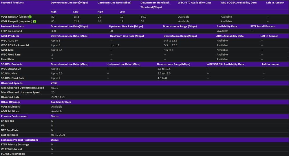

Mine:

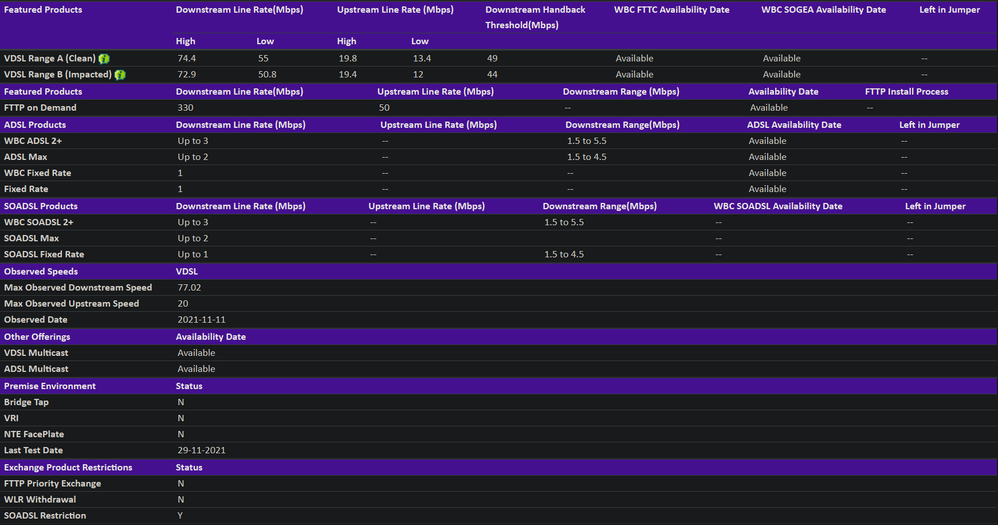

Folks:
Did I read correctly that you previously mentioned (or someone did) that you had the ability to alter the SNR?
If so, could you please change mine to 1 and my folks to 3? Mine used to be 1 but I don't think your router can handle a low SNR.

I've had a look at both accounts again this afternoon:
Parent's Account
We're advised your parents to expect speeds between 59 - 72Mbps, the line is currently syncing at 60Mbps, so it's within expectations, but admittedly is on the lower end. I've found that your parents have a static IP on there, which means they're connected via L2TP. L2TP connection speed is affected by both the Openreach network, as well as our internal connection profile. Our internal connection profile does it's best to match the current Openreach DLM profile, but is sometimes a little slow to catch up. I've just reset it to the highest speed possible, so hopefully, this makes a positive impact.
Your Account
Your line is also connected to the L2TP network, most likely to do with the available equipment at the exchange, though we don't have the same problem here, as internally, your connection profile is already 80Mbps. There are no changes at all that can be made on your account, and the line is operating at optimal capacity, with download sync speeds coming in at 73.1 Mbps, on your contract, we advised you to expect speeds between 50 - 68Mbps.
Again, from a DLM perspective, neither lines are banded at all. Both KBD and RRT line tests aren't picking up any issues either. Beyond what I've outlined above, any further issues are most likely within the home environment. If you'd like us to arrange a Qube engineer visit, who specialise in the home environment, please let me know and I'll get a ticket raised on the account. ![]()
