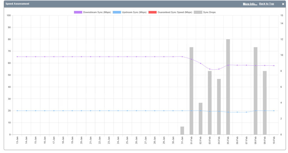

Anyway, looking at the broadband profile, it's current showing as 0.128M-80M Downstream, Interleaving Low - 0.128M-20M Upstream, Interleaving On, which suggests that DLM has had to make some adjustments to the line due to the drops that you've been having lately. The slower speeds are a symptom of an underlying issue, which is causing the line to drop quite frequently.
The only way to resolve this is to have an Openreach engineer take another look, please respond to the open ticket on the account with your availability, and we'll get it re-raised.

@adam945 wrote:
... which suggests that DLM has had to make some adjustments to the line due to the drops that you've been having lately. The slower speeds are a symptom of an underlying issue, which is causing the line to drop quite frequently.
Hi Adam,
Given the apparently "good" profile for this line, can you advise if the DLM discern the difference between a line drop caused by an underlaying fault and a line drop caused by a user repeatedly bouncing the link / changing routers in an attempt to get the "right" speed?  Is there any discernment here, or is a line drop (for whatever reason) just a line drop?
From the graph you've kindly shared, it is noteworthy that on the two days after requesting the DLM reset, whilst waiting for it to go through there were ZERO resyncs.  Also there are no resyncs in the two weeks before the 31st Jan.  It would be reasonable to expect the DLM to improve performance after a good many days without a line drop being detected, but also to firmly manage the line for stability if it sees what it might reasonably believe to be numerous fault events.
