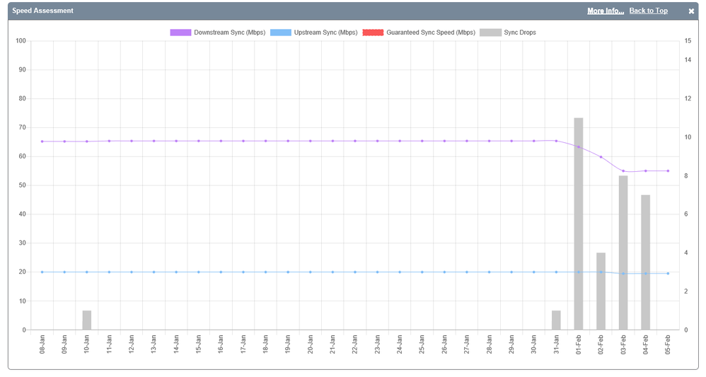

Good morning. I am and have been for a good while, an unlimited fibre extra customer. We used to get the full 66mbps connection. I have recently noticed that although still on the same package we only receive 57 to 59 mbps with an average of 53mbps and guaranteed minimum of 47.8 mbps. quite a drop from the previous 66 mbps we were getting. Is there a reason for this?

Hi there @digg3r, I am sorry for the delay in picking up your post and for the issues you have experienced with your speed. I'm sorry for the inconvenience the drop has caused.
It looks like you have since been in touch with our team and a fault detected in the network with an engineer booked in.
Let us know how this goes and please just get back to me if you have any further queries in the meantime.

adam945
Posts: 2,319
Fixes: 113
Registered: ‎01-12-2020
Re: Broadband speeds
Hello @digg3r
Thanks a lot for providing us with the information above. For some strange reason, a GEA test doesn't show that the line is banded at 55Mbps, whereas an RRT - which is more accurate, especially with FTTC connections does. The banding is a symptom of a few drops that can be seen over the last few days.
Going forward, I'm going to raise a DLM reset request, which will likely be picked up on Monday, and will be actioned within the next 72 hours.
It's worth noting that interleaving is currently turned on, which is also a likely cause of higher ping times.
Let's see how we get on once the line is reset, and let us know if you have any further issues.
 Adam
 Plusnet Help Team - Leeds

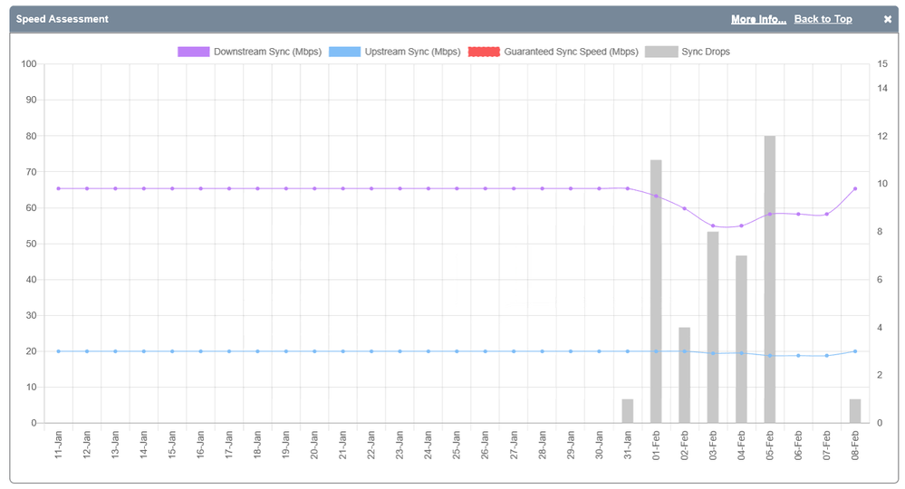

Good afternoon, Im assuming the restart has been done as my ping and speed has stabilised. But... We pay for fibre extra @66mbps but still only receiving 55mbps at max. But average 48mbps. We were getting full speed before the contract ended and now we pay more out of contract but seem to have been capped at a lower speed. Can you tell me why we are not receiving the full speed but being charged £43.40 out of contract. that is £15.51 increase for slower connection.
adam945
Posts: 2,319
Fixes: 113
Hello @digg3r
Thanks a lot for getting back to us. I've just run a test on your line and sync speeds now appear to be back where they were, coming in at around 65.32 Mbps (RRT - always a day behind). I'm keen to see the data rate on your router. If you're using our Hub, can you please log into the Hub Manager and upload a photo of your helpdesk page, making sure that you cover the account username?
 Adam

digg3r
Posts: 24
Registered: ‎04-02-2022
@adam945 @Gandalf  Please see attached speed test for this AM. Latency is still higher than before and speeds lower than they were prior to end of contract. There has been "nothing" changed with regards to settings on my router. the only thing that has changed is the price of the service.
VDSL Link Downstream Upstream
Connection Speed 58030 kbps 20000 kbps
Line Attenuation 14.1 db 14.0 db
Noise Margin 6.0 db 6.5 db
