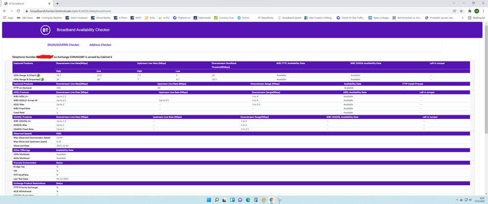

BTW Performance tester 17.57mbps download 6.16 upload no faults showing today but was showing faults a couple of days ago.
Quite line ok.
Line tester?
Telephone Number
Featured Products Downstream Line Rate(Mbps) Upstream Line Rate (Mbps) Downstream Handback
Threshold(Mbps)
WBC FTTC Availability Date WBC SOGEA Availability Date Left in Jumper
High Low High Low
VDSL Range A (Clean) help 34.7 22.4 7.1 5 20 Available Available --
VDSL Range B (Impacted) help 34 20 7 4.7 16.5 Available Available --
Featured Products Downstream Line Rate(Mbps) Upstream Line Rate (Mbps) Downstream Range (Mbps) Availability Date FTTP Install Process
FTTP on Demand 330 50 -- Available --
ADSL Products Downstream Line Rate (Mbps) Upstream Line Rate (Mbps) Downstream Range(Mbps) ADSL Availability Date Left in Jumper
WBC ADSL 2+ Up to 2.5 -- 1 to 4 Available --
WBC ADSL2+ Annex M Up to 2.5 Up to 0.5 1 to 4 Available --
ADSL Max Up to 2 -- 1 to 3.5 Available --
WBC Fixed Rate 1 -- -- Available --
SOADSL Products Downstream Line Rate (Mbps) Upstream Line Rate (Mbps) Downstream Range(Mbps) WBC SOADSL Availability Date Left in Jumper
WBC SOADSL 2+ Up to 2.5 -- 1 to 4 -- --
SOADSL Max Up to 2 -- 1 to 4 -- --
SOADSL Fixed Rate Up to 1 -- 1 to 3.5 -- --
Observed Speeds VDSL
Max Observed Downstream Speed 19.99
Max Observed Upstream Speed 6.33
Observed Date 2021-12-10
Other Offerings Availability Date
VDSL Multicast Available
ADSL Multicast Available
Premise Environment Status
Bridge Tap N
VRI N
NTE FacePlate N
Last Test Date 01-12-2021
Exchange Product Restrictions Status
FTTP Priority Exchange N
WLR Withdrawal N
SOADSL Restriction Y
The exchange is not in a current fibre priority programme
Thanks for looking
Mick

@mickatmian Thanks for those details, although a screenshot of the BTW Performance Tester is a little more informative than just posting the figures you have - there is detail there which can be useful.
Don't understand your Line tester? query, and you have missed the Hub Help Desk page which is also very useful.
You are obviously a long way from the VDSL box, as you were from the exchange. Are you very rural?

@JAB 1
I am approximately 1k from the VDSL box (fibre box?) and 4k from the exchange so yes very rural. For information my neighbour 80 M further from the box almost never has a problem and constant speed around 24mbps he is with BT not that it should make a difference.
For information.
I have been with Plusnet for a number of years during which time I have had an untold number of Openreach engineers visit the last of which (3months ago) said a section of the copper line had been replaced, the line in was clear and around 31mbps, He also checked my house wiring, box etc no faults, but suspected the router was faulty. Plusnet insisted it was not faulty and reset it from their end which gave me a speed of 28+mbps so I guess the Plusnet engineer was correct. when the router speed dropped to 20ish mbps I contacted Plusnet and was told the line speed was showing 31mbps but as I was still getting more than my 15mbps guaranteed speed they would not do anything! Pathetic really.
I have reset the Hub 1 router etc. before posting. Not sure if it needs a firmware/software update.
I mistakenly? thought the test you asked for was a line test sorry.
Thanks for your help
Mick

Mick, looking at that BTW report above, you should really be getting around the 30Mb/s mark. Distance from the exchange is irrelevant, but over half a mile from the cab will reduce your speeds. Can't remember the distance/speed reduction correlation off the top unfortunately.
The final piece of the jigsaw - for non-PN people to help - is your Hubs Help Desk page - the picture below should help you find it.
