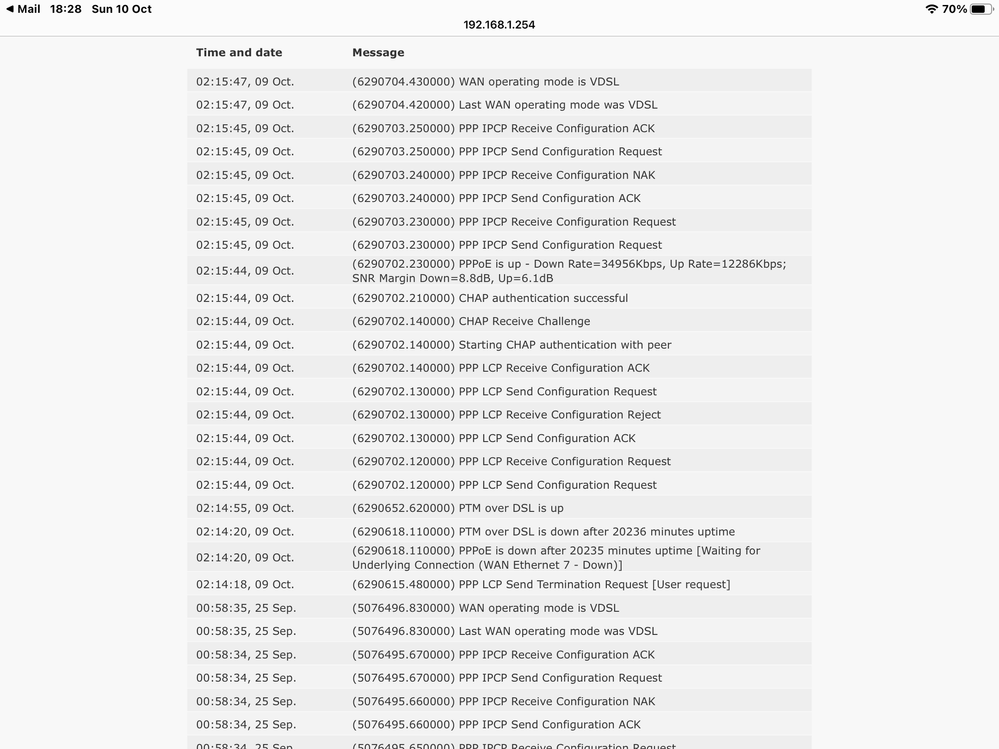

@adam945 Thanks for that detail, but I think you may have missed what the OP is saying - the connection is dropping out fairly regularly - especially prior to your Radius graph, and there is RFI (hard to remedy) and crosstalk (full cab?). The profile data also suggests there may be network problems?
With respect, it is not their local environment, other than possibly the RFI, which is at fault, more the line downstream of them.

I'm not so sure there isn't a network fault - looking at the logs provided by the OP earlier in the thread, which I suspect have given rise to the banding, which is why I am querying the need for the OP to run tests which, unless they are very lucky (or unlucky) depending on your viewpoint), will return a 'no errors found - just put up with a sub-standard service' response from the automated bot.

@adam945  I don’t know why it’s only showing one drop-out. This happens every day. Often several times a day. My router is in the same room as the tv, iPad etc and it’s a very small room. Do I still need to change the wireless band? I’m useless with technical things so I don’t want to change things unless I have to, in case I make things worse. Also, do you want me to connect to the test socket permanently? This fault is intermittent and I can’t tell exactly when it’s going to drop out again.

Sorry to ask again, but could you post your current WAN logs?

The WAN log is still showing the same stuff as yesterday. I can’t find anything more up to date.

Yep - you will need a dangly filter before you can plug into the test socket. Did PN not supply one with the router.? Don't worry about the logs not being any more current - the ones above prove there is is an issue.
