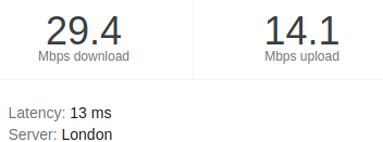

When I did the speed tests, I was using a Cat 6A cable connected directly to my computer. I have also carried out tests on another machine and both are odd. Sometimes I get 32mbps downstream speeds as shown below with low ping and more often, I get 20-27mbps speeds with >50ms ping.
Here is another speed test I just did now with no devices connected to the network using a Cat 6A cable wired directly from the router to my laptop. This was the best I got out of 3 tests:
Here is the sync speed info from my router:
Here is the info from the availability checker:
I am not an expert but I suspect there might be something wrong with the actual master socket in my home (but it's unlikely because its only 3yrs old). God knows. Thanks haha.

I have done a speed test using my laptop wired up to my router with no other devices on the network (attached above)
I have also just done another speed test using my desktop computer which is also wired and here are the results:
(using Google)
and:
(using speedtest.net)
This is pretty much the best speeds and pings I have gotten in a couple days. Its been over 50ms for a while.
I am getting performance issues constantly with web pages not loading in, so I need to refresh sometimes which works after a few tries haha.
