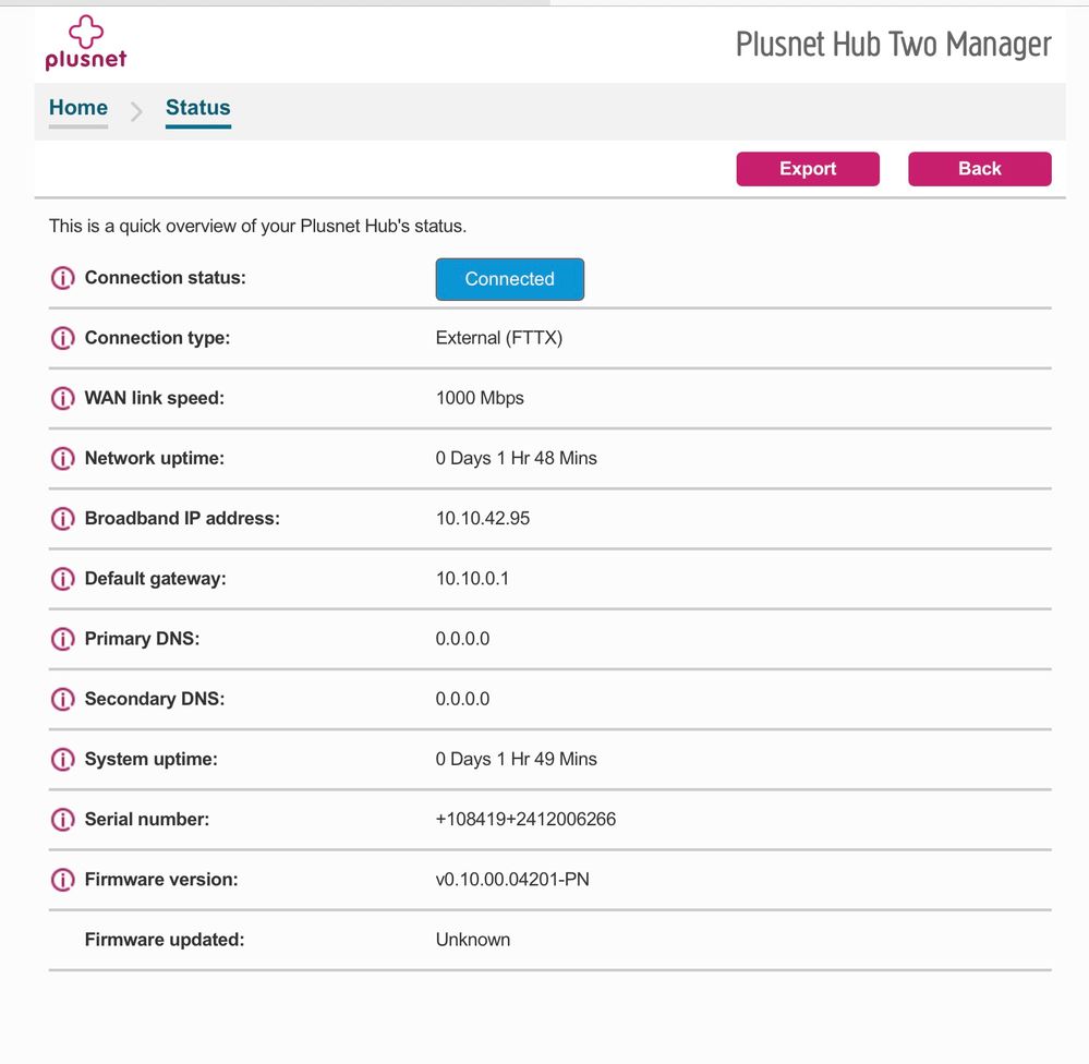

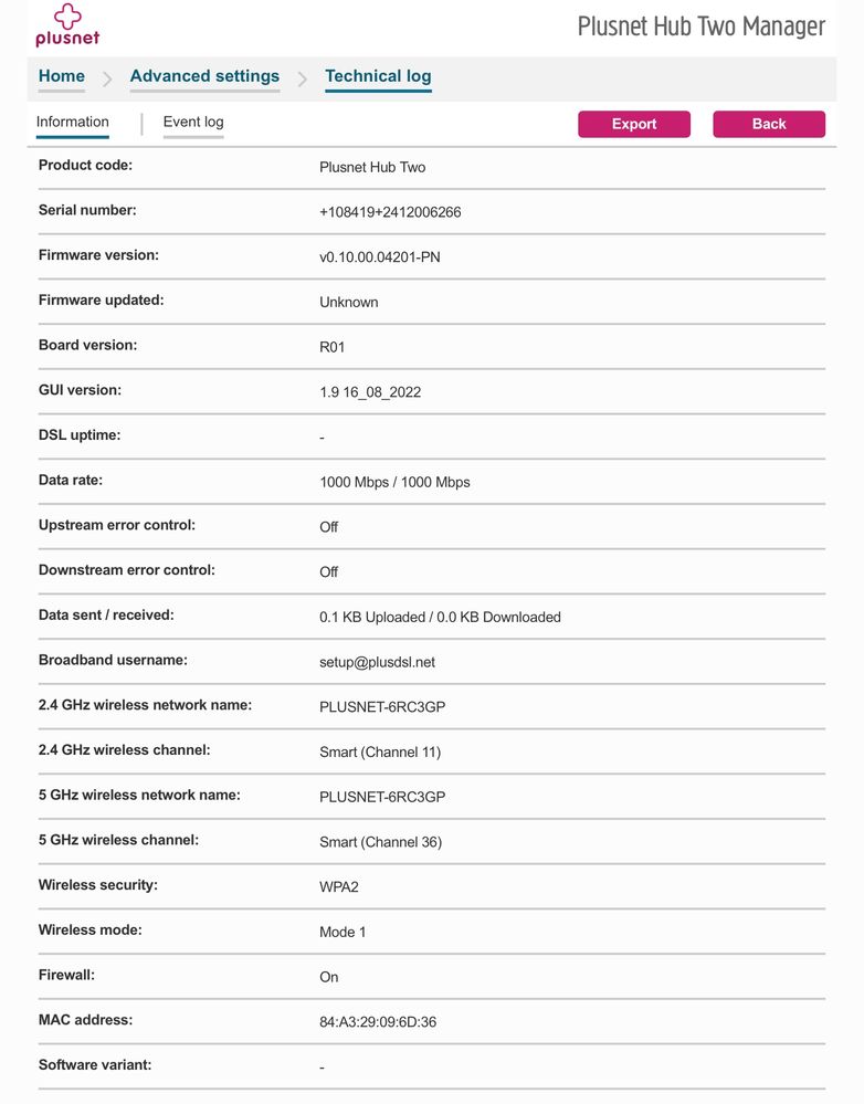

OK. In that case, just in case I can, possibly, see what may be the issue, can you pst pictures of the three Hub screens below:

Thanks for that, @Tyger-Lyons . Try updating the broadband user name to your own instead the 'setup' showing in the first two pictures above and then see what happens.
There are a couple of other oddities in those pictures, but hopefully putting the correct username (and password), will correct them.

Hi John I’ve already done that as per my initial comment. It made no difference so I did a factory reset which reverted back to what you see now.

OK, @Tyger-Lyons  (nice name, BTW), in that case, it appears you need to contact Plusnet - something on your account is wrong, as it should auto-fill that on a factory  reset.

If you are still here, @Tyger-Lyons  -when you speak to PN Support, ask them to check that your Hub is definitely associated with your account - the fact it goes back to 'setup@plusdsl.net' and has that 'private' IP suggests to me that it isn't.
