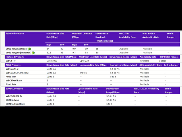

I wonder what the speed estimate for the line are on a BTW DSL check? If you get a chance could you post a copy?
Yup here you go. Interestingly, FTTP is available.
@Justin4 if you call our Customer Options Team on 0800 013 2632 we'll be happy to migrate you over to BT or EE's FTTP (fibre to the premises) which may be a lot better in terms of reliability and speed.

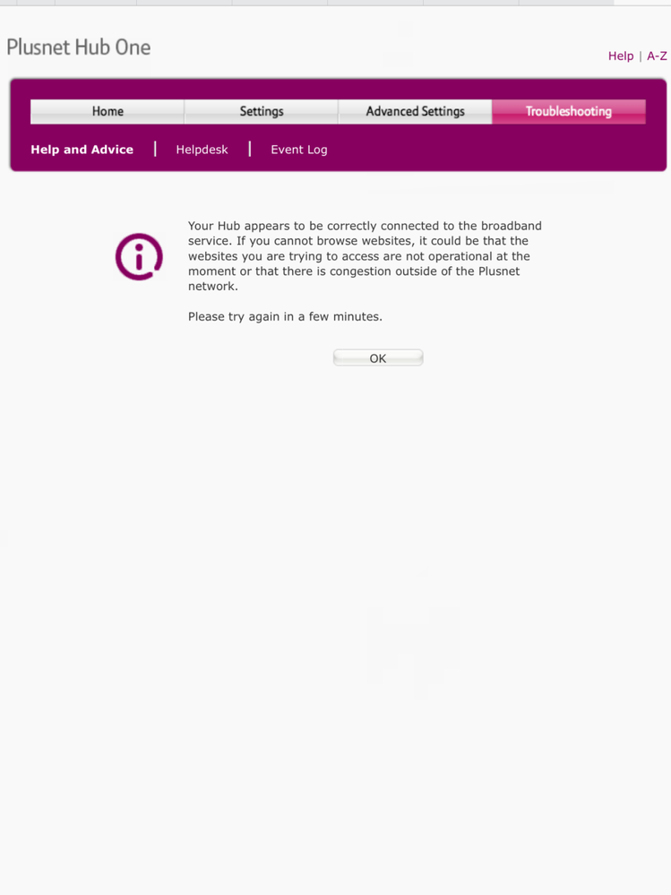

Yes - the picture below may help:
Justin4
Posts: 21
Registered: ‎25-01-2021
Re: Best way to report terrible broadband speeds
test A.pngtest B.pngtest C.pngtest D.pngThanks John. I did a successful speed test last night (with Ethernet connection) that showed a very respectable speed. I'm still not sure I have found the information you are after via my hub manager John but here is what I get when I go to troubleshooting.
