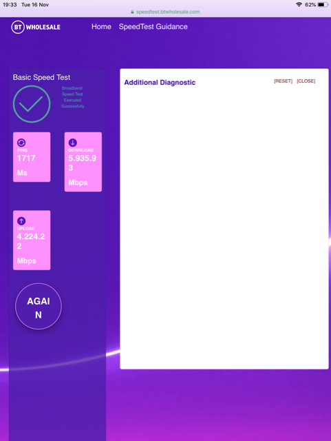

Justin4

@Justin4 Why are you testing on an iPhone - I assume you have a desktop/laptop, which will give a better  picture. That last post is useless.
Have you seen  @Gandalf 's post above?

Thank you Anoush, John and Baldrick 1,
I am grateful for your help, I have posted a test I did last night. when I had problems in the past with the speed I spoke to some one at plusnet who talked me through (what I understood as) dividing my broadband in to two, so some devices use 5GHZ this did help at first but now I am back to waiting for picyures to load on instagram.

Justin4

Hey John,
I did not do the test  on an iphone, I tested it on my ipad as no I do not have a laptop.
Why is my last post useless, cant you read it?  Your obviously more technically minded than I am and getting frustrated that this stuff doesn't come as easy to me as it does to you. I have thanked you for helping me, but please try and be a little more patient, I'm not a tech savy 20 year old and I am doing my best!
Yes I have see @Gandalf's post and have thanked him, and I thanked you again!

@Justin4
The sad fact is that to sort this problem out you will have to try and help us to help you.
@Gandalf  is reporting that your line is banded. The results that you have posted show much lower speeds than this banded speed plus horrendous latency, so there is very probably something else going on as well.
An Ethernet cable would have been included with your hub, so you have had one. Alternatively they only cost a few pounds. Using one is the only sure fire way of confirming my suspicion that in addition to the line banding you have a wireless problem.

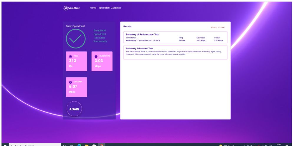

Justin4
Posts: 21
Registered: ‎25-01-2021
Re: Best way to report terrible broadband speeds
