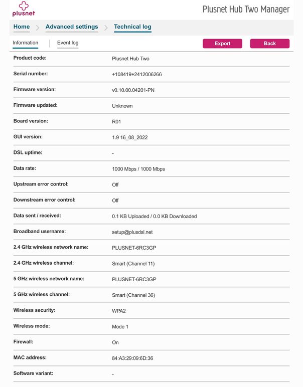

We moved from TT to Plusnet on a 500mb service.
several members of the family are reporting intermittent issues with performance.
Including over the last few days when on their PS it would keep telling them are offline and then online.
What appropriate tool set to test over an extended period of time ?
i don't think there is a speed issue, but rather a routing and/or quality issue.
Happy to run the appropriate tests before jumping to any assumptions.
Regards
C.

@ColinKent I suggest, although others may have different ideas, that sight of your Hubs Technical Log>Information would be useful. I don't think there is a 'tool set', as such, to do otherwise.
From other posts, I have a feeling the issue is with the PS.
Sorry what is meant by PS ?

With respect, @userfred , that will not reveal 'disconnection' issues, only slowdowns - which is why I suggested sight of the error log.

As @jab1 suggests, view of the Technical log would be most instructive.
In addition, is the connection between Hub and PS wireless or via an Ethernet cable? If wireless do you get the same drops if connected via Ethernet?

Looking at examples of the Hub Two Technical Information page for Full Fibre I am not sure if it will be of any help
The only useful data might be Data Sent/Received
The Home >Status or Advanced Settings >Broadband both show the connection uptime important for knowing if any broadband disconnects have occurred
I would say the Event Log would be the best, as the symptoms might suggest device disconnects

Sorry @Dan_the_Van , maybe posting before my third coffee meant I asked for the wrong data - I did actually mean the Event log.
