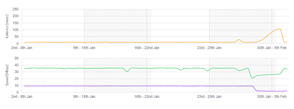

Just thought to check my Unifi logs and can now see that the 2mb upload is a very recent thing, Looks like downloads were also impacted for a while but that is recovering. We've all been home as our daughter has Covid right now so it's been very apparent this week. Can I expect things to sort themselves out? speedstats.png

Thanks for reaching out @mcaddy and I'm sorry to hear that you've been having issues with the upload speed. The graph you've provided above looks identical to an RRT on my side, so there was clearly an issue,
Anyway, has the router reset helped? A GEA test on the line today is showing upload speeds of 10Mbps (the RRT is always a day behind so it's not clear on there).

Thanks for the follow up, a reset of the Open Reach Modem was all that was required to restore my upload speeds.
