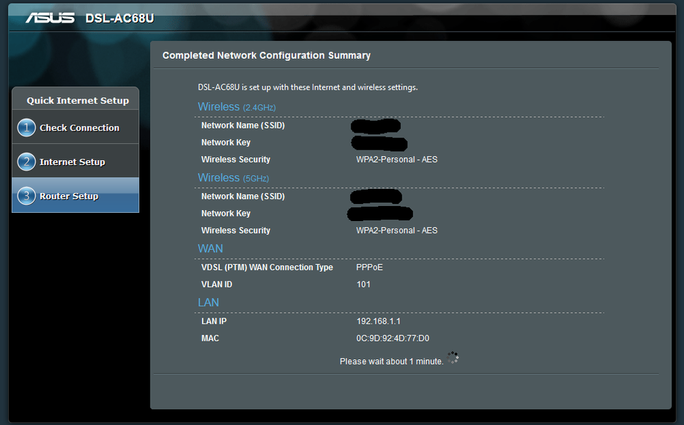

First off I should say that the Plusnet Hub One hub that was supplied works fine so there is no problem with my internet connection in itself. The problem is when using the ASUS router: -
Asus DSL-AC68U router connected to ADSL OK but, after switching to fibre broadband with the same ISP (Plusnet) all attempts to connect to VDSL Fibre broadband failed. Asus router is VDSL capable and setup process, via Firefox web GUI, completes but cannot then connect even after several ‘Reset’ attempts at setup ensuring that details are entered correctly.
System Proxy servers are off and Firefox is set to 'Use sytem proxy settings.
Initial attempt resulted in spinning wheel and ‘Please wait about 1 minute’ but no connection after setup so exited Firefox after 10 minutes.ASUS3a edited.png
I deleted Firefox cookies and made further attempts to connect. These resulted in the spinning wheel and ‘Please wait about 1 minute’ scenario again and still does not connect, even after waiting 15 minutes.
Seems that the Asus is unable to connect to Plusnet fibre broadband.
Question - Am I missing something or is it Plusnet not allowing routers other than Plusnet’s own routers and maybe BT/EE routers to connect to their fibre broadband?

I can't configure the ASUS because I can't access the user interface until it is set up and I can't set it up in the first place. I am in a catch-22 situation.

@Madeleyite  What you are saying does not make much sense, you must be connected to the Asus to get that screenshot in your first post. Access to the router user interface does not require a connection to the internet and can be done over a local ethernet or Wi-Fi connection
Have you entered your Plusnet Username and Password on the PPPoE set up page?
I'm afraid @RichardB is correct. The DSL-68U has probably the worst ever VDSL2 modem chip in it. Unless you are on a very short line to the fibre cabinet you can expect problems. It does not get on well with the Openreach line management system (DLM).☹️

@RealAleMadrid - The screenshot I showed was during stage 3 of the initial setup process and I am not able to enter the  user interface (UI) after the failure to finally connect. To get to stage 3 of the setup, yes I did enter my plusnet username and PW but not able to complete the final connection. See the small text at the bottom with the spinning wheel. It never completed.
When I was on ADSL I was able to enter the user interface (UI) to edit ASUS settings. There are the default username and associated PW but I edited it so that I had my own username and a different PW. Since changing over to VDSL all of these show as being incorrect so I cannot enter the UI anymore to edit settings.

@RichardB - Thanks for your input. I have given up trying to connect the ASUS router via VDSL even though it states it supports VDSL2. It was OK with ADSL.
