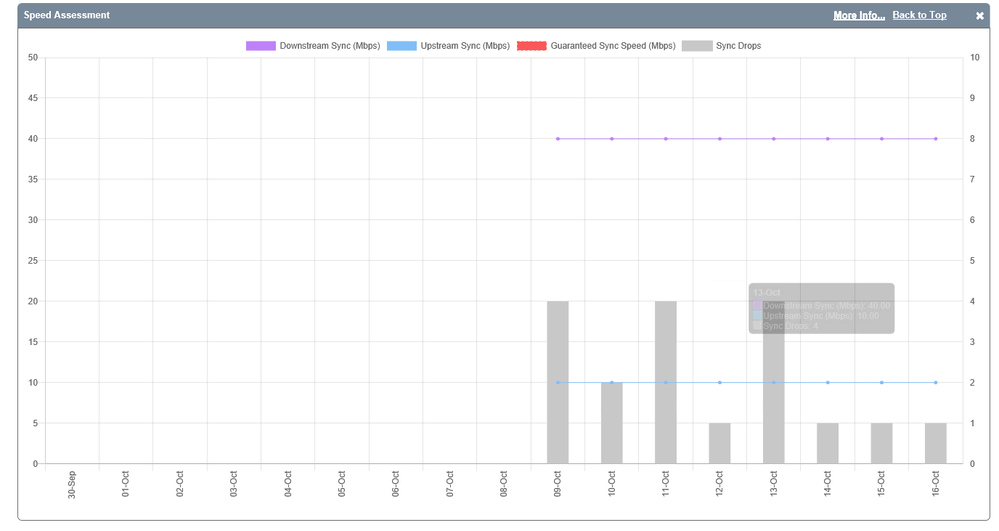

Explain the help desk on hub to me a bit. I'm not sure how to do that. This one, was done over wi-fi I'm setting up my laptop to be able to try ethernet but the location isn't really usable in the long term but I can test with it.

OK - a picture paints a thousand words. 😉
Log in to the Hub, click the Troubleshooting tab - top right, a then the Helpdesk tab.

1. Product name: Plusnet Hub
2. Serial number:
3. Firmware version: Software version 4.7.5.1.83.8.263 Last updated Unknown
4. Board version: Plusnet Hub One
5. DSL uptime: 0 days, 01:27:28
6. Data rate: 9999 / 39950
7. Maximum data rate: 10746 / 60618
8. Noise margin: 6.9 / 14.2
9. Line attenuation: 33.7 / 22.2
10. Signal attenuation: 33.7 / 20.7
11. Data sent/received: 113.9 MB / 1.9 GB

Posts: 22,759
Thanks: 7,972
Fixes: 334
Re: 2mbps-39mbps variation in d/l
Thanks. From the Helpdesk: You appear to have had a DSL drop about 90 minutes ago - which suggests there could be network problems on the BT network. Your downstream SNR may be a bit high (a consequence of this/previous drops?).
That is your LAN log, which doesn't give much useful data in this case - can you post the WAN log?
adam945
Posts: 2,319
Fixes: 113
Registered: ‎01-12-2020
Hello @sanguinius
Thanks a lot for reaching out and I'm sorry to hear that you're having problems with your service. Tests on the line from my end are showing that the line has consistently been syncing at 80Mbps since your upgrade to fibre was completed.
How are you doing your speed tests? Is it over WIFI or are you using an Ethernet connection? Bare in mind that WIFI speeds can fluctuate based on what else might be connected and is in use at any given time, WIFI channels, bands etc.
That;s not to say that there aren't any faults on your line though, because there is, while running a test on your phone service I've found a disconnection in the network. This has now been raised to Openreach and we#re hoping to have it resolved by Wednesday. I've created an open fault Ticket which you can both view and comment on for direct comms with our Tech Support Team here.
One last thing, are you turning your router off through the night? A visual radius appears to show that you are, this can make the line more susceptible to being banded if DLM assumes that there's an issue with the network.
 Adam
 Plusnet Help Team - Leeds
Posts: 22,759
Thanks: 7,972
Fixes: 334
@adam945 Thanks for that. At least you have found a line fault, which I 'suspected', but you have definitely found a huge contributory factor if the OP is switching the hub off every night. I'm surprised DLM hasn't intervened and banded the line severely.

@sanguinius From what @adam945  has posted, I doubt the engineer will need to visit you.
The reason it is always advised to leave the hub powered up is that continuously turning it on and off will lead the automatic Dynamic Line Management equipment in the street cab to assume there is a problem, and it will at some point decide to massively reduce your speed, and/or increase the SNR (as it appears to be doing) in an attempt to maintain stability.
You don't turn your fridge/freezer off, do you?
