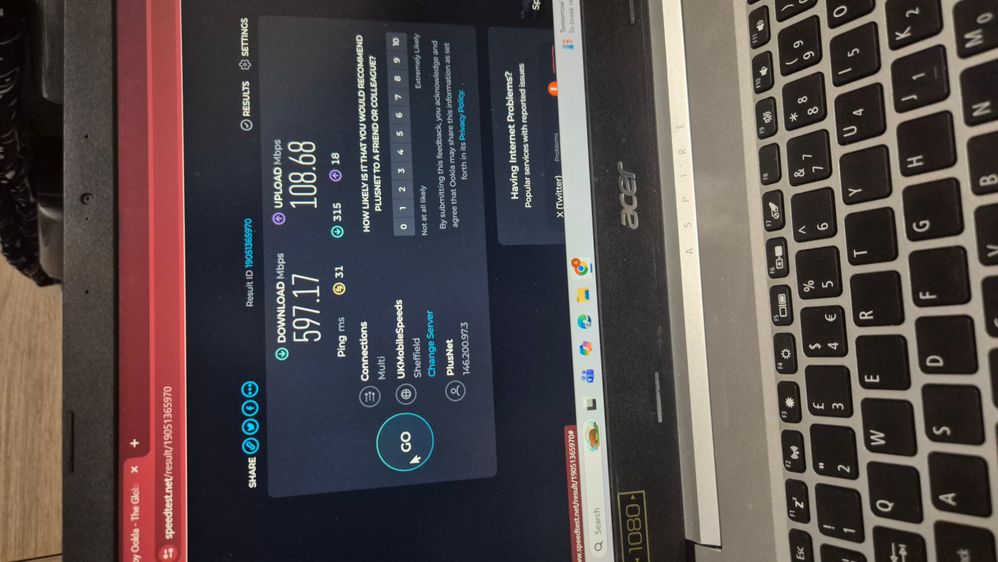

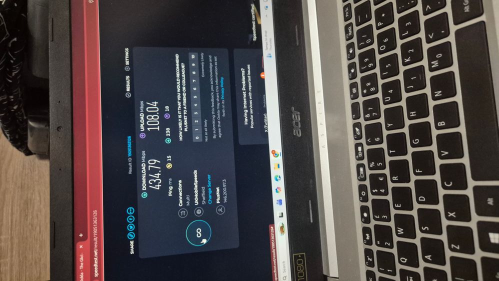

The following images were taken on 4 speed tests on a wired connection, as i said my speed is a lot lower than the guaranteed speeds and also noticed occasional high ping, now my connection seems to be dropping randomly aswell.
Possible unstable connection?
Posts: 24,881
Thanks: 8,920
Fixes: 381
Re: 1/4 speed
@Huntleyroe I'll leave the speed explanation to  @Dan_the_Van  / @Townman - they have more knowledge/experience than me.
You say 'now my connection seems to be dropping randomly aswell.' How are you determining this?
