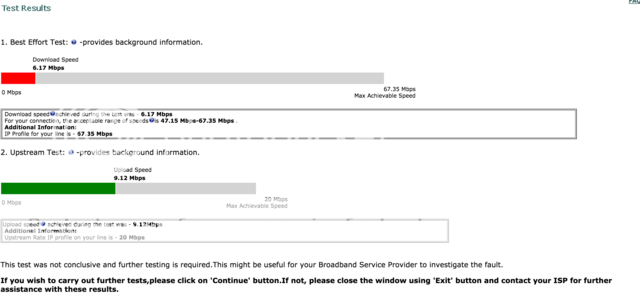

Perhaps someone at Plusnet could look into this please
Its been bad all day so after a few hops i am presented with this, and i cant find anywhere to report a possible fault.

Can you identify the full path of the Gateway you are on with the low speed please as suggested in reply #428 (and reply #424) of the Capacity thread.

Re: your reply #1 and my reply #2, I see that in the Gateway thread you identified the gateway as link3-central10.pcl-gw01.plus.net (84.93.249.164) (believed to be pcl-bng02). Are you still connected to that and are your issues continuing?

Is it possible for you to carry out the additional steps after the BT Speedtest fails?
