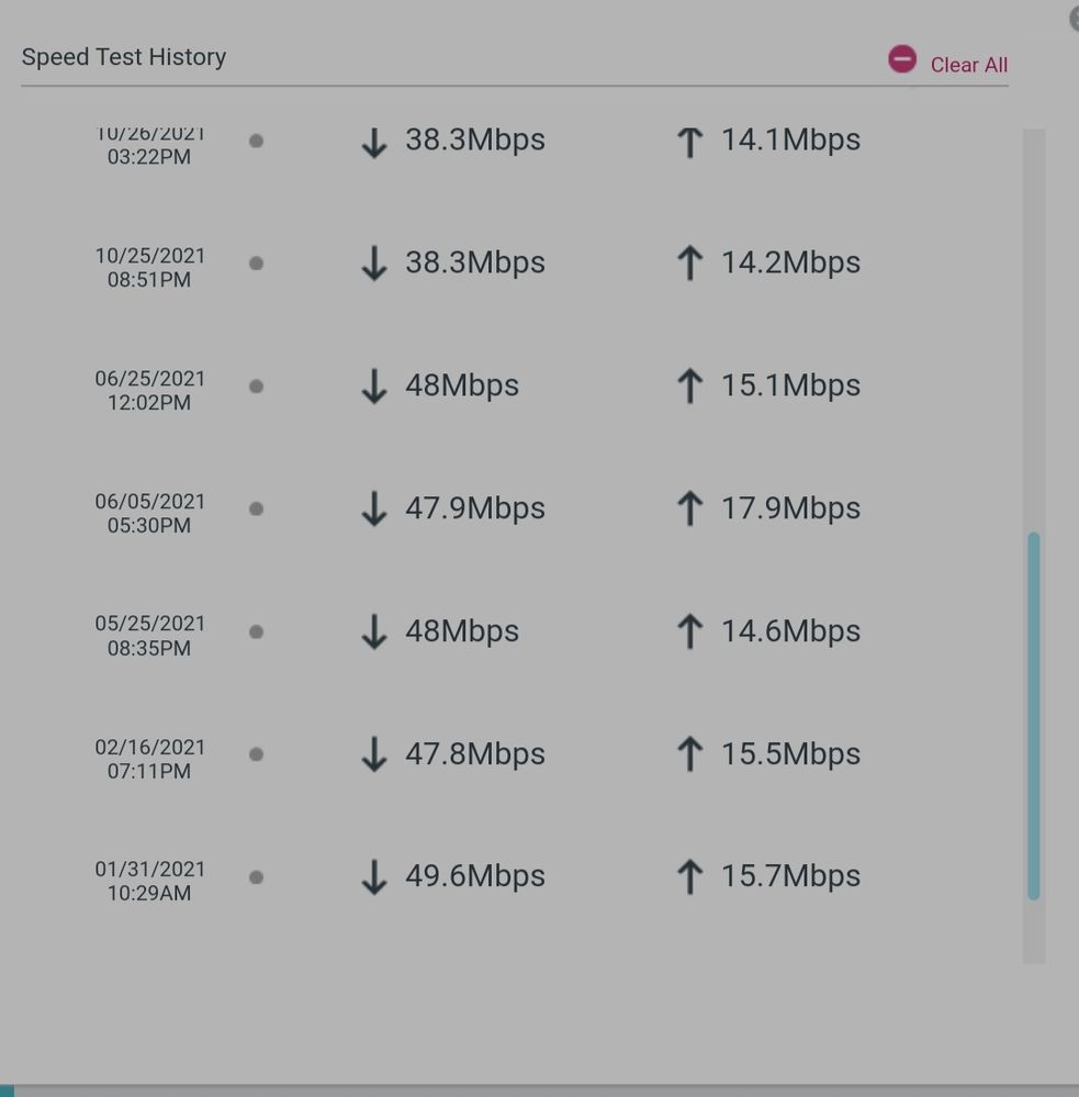

Hi,
I've been monitoring my line speed periodically, and have noticed the speed of from around 50mbps when first set up, to around 40mbps in recent weeks/months.
Is this something worth investigating, or will I likely just be fobbed off by PN?
Cheers

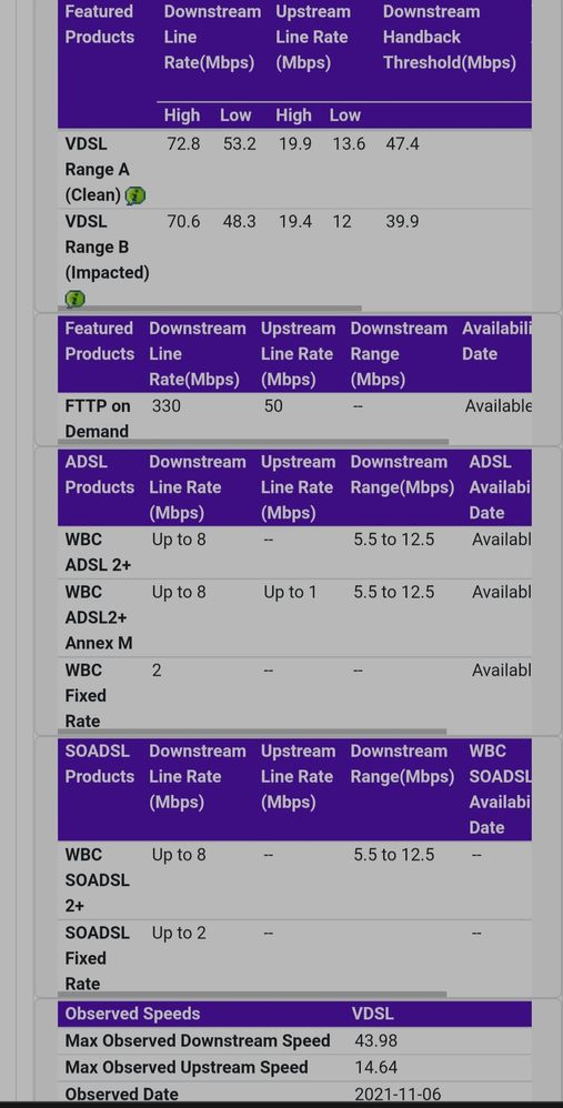

06-11-2021 1:30 PM
Hi @OhWell
What do get if you use the BT performance test at http://speedtest.btwholesale.com/
And the broadband checker: https://www.broadbandchecker.btwholesale.com/#/ADSL
Dave

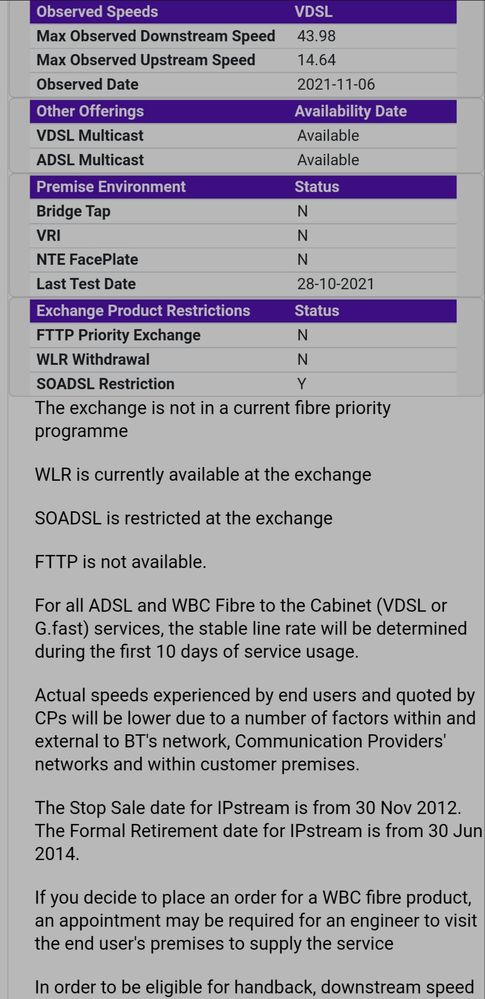

Re: Line speed reduced over recent weeks/months
06-11-2021 5:46 PM
06-11-2021 6:17 PM
Looks like a fault that you should phone support about. 0800 432 0200. They close at 7pm
