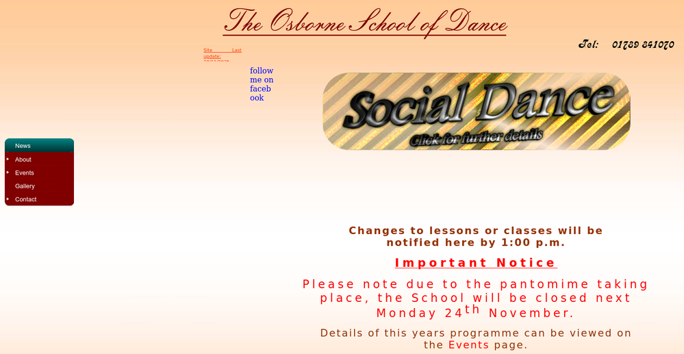

I don't know whether it is my setup, but there seems to be several screen layout problems on some of the pages -
- The formatting of "Site Last update" looks a mess and is partially obscured
- "follow me on facebook" - why does it look like that ?
- why is the left hand menu so far to the left ? - it looks like it's width is interfering with the centring of the rest of the page.

As for the layout issues on our site, it looked okay on my PC. As long as the information is visible to the people who need to see it, not as if we're a major global corp 😏, we can live with it. Thanks for pointing it out @MaxSync but the look of the site isn't our top priority. 😉
