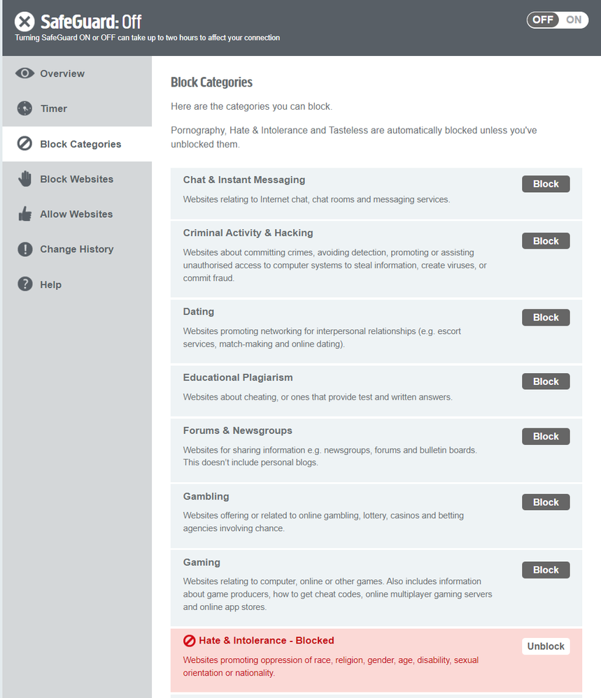

Hi there, my portfolio website has been labelled as Hate Speech on the Plusnet safeguard system. This is absolutely not the case and I would like help getting it recategorised please.
I see a few people on the forum have managed to fix this issue with help from @bobpullen
The website is marckeeling.co.uk, and is literally just some 3d renders and descriptions of my work. The only thing I can think that could have flagged the system is mentioning the word 'disabled' when referring to a group of artists I worked with, which is a bit crazy. I have changed the term to SENT artists to avoid it, but still need help getting it unfiltered please.

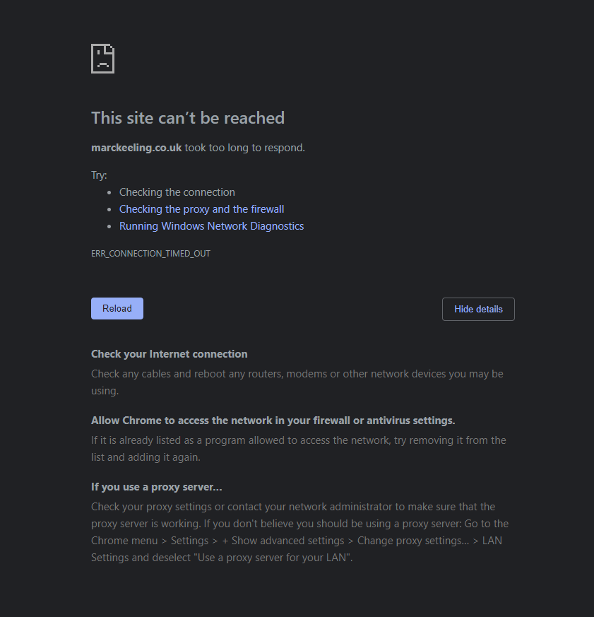

@marcKV I'm sorry my bad. I didn't realise it was happening even when safeguard is off. Off means off so there's something broken here. Just to check then, right now with Safeguard off visiting marckeeling.co.uk, what do you see, can you screenshot it?
James - Plusnet Sheffield
marcKV
Posts: 16
Registered: ‎26-07-2023
Re: Website flagged as Hate Speech incorrectly on Safeguard
@James30
If give an error similar to that of having no connection at all.
If I disable the category then it loads fine.

@marcKV  - On the face of it, it doesn't look relating to safeguard to me unless there's is some really quirky network issue. I can access it here, look's pretty snazzy I must say. I've seen similar issues accessing a random site like a network level block on your IP address on the webserver. Although the IP's are dynamic and should change, they aren't forced to and yours has been the same for while. Usually I would suggest rebooting the router to get you a new IP assigned but if it hasn't done it yet then I can't see it doing it now. Daft question but can you get on other sites and have you tried another devices on the same network?
We could try assigning a static IP?

Yeah thanks I am aware of that. Safeguard wasn't never enabled. This started happening about 4 days ago. Safeguard was off, and have always been off, however those three categories are enabled by default.
It was suggested to me by technical support that I disable the catagories to check if somehow safeguard was causing the problem. As soon as I turned the hate and intolerance option off (safeguard still being off) and restarting the modem, the website loaded. I have since experimented with it on or off, but it makes no difference for my particular website.
If hate and intolerance is enabled, it doesn't matter whether safeguard is on or off, the website will not load.

@James30
Yes I have tried on different networks, they work fine.
Plus connecting to a VPN works from the same PC.
If I used the same network on a different device, then it also doesn't work until that option is disabled.
It is definitely Safeguard related at least (maybe a bug ofc) because I have tested it 10-15 times turning "hate and intolerance" options off and on.
The site only loads when that category is disabled (again it doesn't matter whether safeguards main switch is on or off).
The steps I have repeatedly tried:
Safe guard off - Hate and intolerance on - restart modem: Website doesnt load and gives that error
Safeguard off - Hate and intolerance off - restart modem: Website loads
Safeguard on - Hate and intolerance off - restart modem: Website loads
Safeguard on - Hate and intolerance on - restart modem: Website doesnt load and gives that error
I have tried this many times.
I will add that it doesn't seem to affect any other websites for the sake of experiment.
For example adult content can be accessed with the category "pornography" enabled with safeguard turned off. If I turn safeguard on while that category is enabled, then it cannot.
