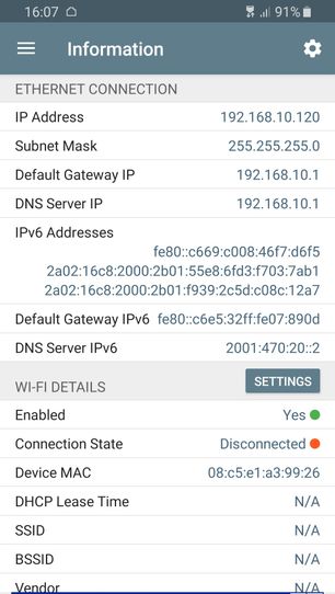

I think you'll find if you plug in a usb ethernet dongle a samsung phone will use ethernet in preference to Wireless
Using an old Samsung S8
Plugging in the dongle disables the Wireless interface.

@Dan_the_Van   I didn't suggest it couldn't be done but a somewhat unusual way to connect a mobile phone. I have a USB-C to Ethernet adapter, maybe I'll try it on my Iphone.😀
Posts: 4,979
Thanks: 3,287
Re: Using Powerline Adapter with Samsung phone and HubTwo
@RealAleMadrid
Just confirming it does work, although the OP had by their post.
Agree an unusual way to connect to a network but if you're in a poor wifi signal area and you have the spare equipment. .
