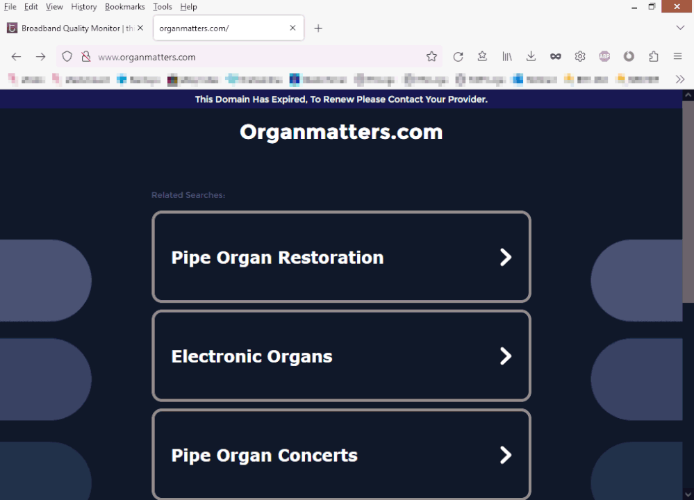

Now that I've got time to prepare and post the screen image grabbed at the time, this is what was happening whenever I tried to access the site myself via my PN connection and using PN DNS ...
organ%20matters%20domain%20expired
... but only if I disabled adware blocking and ignored the lack of a valid 3rd party SSL certificate. Otherwise all I saw was an apparently blank page. Apart from a short period of time at stupid o'clock on Monday morning when it worked as expected, it had been like this for at least a week if not 2 or more.
What appeared to have happened was that the current registry whois data included the current and correct authoritative nameserver details. However, the current authoritative nameservers themselves, whilst providing the correct A record data for the current host server, were also actually dishing out NS records pointing to other nameservers. Presumably, either the previous authoritative nameservers or just some other clearly dubious data. Hence much confusion various !  Once the duff NS record data was corrected, the PN DNS subsequently updated fairly rapidly due to the low(ish) TTL and all was then well.
What I don't quite understand though is how the likes of OpenDNS and google managed to ignore the authoritative nameserver NS records telling them to obtain data from elsewhere and obtain the current and correct A record data ... and/or why PN DNS apparently insisted on doing the complete opposite !
