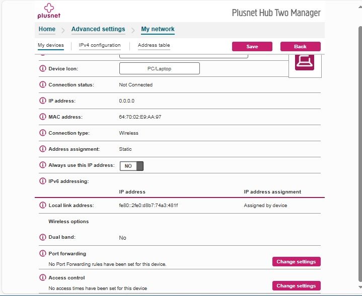

@pvmb
I have a Plusnet Hub 2 router and no such page appears on my router settings.
Home >My devices or Advanced settings > My network >My devices
If you click on any device on the list it will open up the page you claim not to have. So nothing is wrong

I read some info yesterday on IP 0.0.0.0, there's an interesting article on wiki (https://en.wikipedia.org/wiki/0.0.0.0). From what I remember the PC sets 0.0.0.0 when it can't connect possibly due to a conflict and I noticed another unidentified device on my network also using static addressing but it wasnt 0.0.0.0. I've tried a different PCI WiFi adaptor which also didn't connect. I don't use this PC much, the last thing I did was install an Epson wifi printer 4 weeks ago. I have got a USB WiFi adaptor. I'm going back to basics, everything out and restarting to see where that gets me.

@philipdhedley
In the past I have found when a device connects to the Hub it checks to see if an IP Address is present on that device.
If it finds one it will be added to the devices list and marked as a STATIC IP, (the IP Address can be in the IP Address pool)

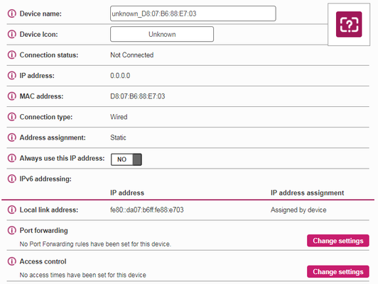

Today I mistakenly connected a router WAN port PPPoE configure device to my Hub Two, this is the result
Looking at the router WAN settings it was IP 0.0.0.0.
IP Address 0.0.0.0 are often used as a place marker in configuration screen as a way of bypassing no entry field
In your device screen shot the MAC Address indicates this is for a TP-Link wireless device, is this a USB device or something else? It also indicates it's Not connected
Can you confirm you are not using the Hub Two WAN port for any connections? Do you have any wireless access points on your LAN which might have DHCP server?
