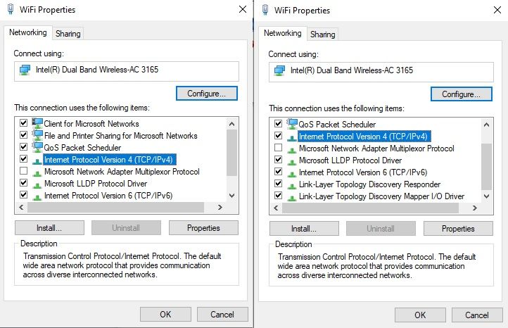

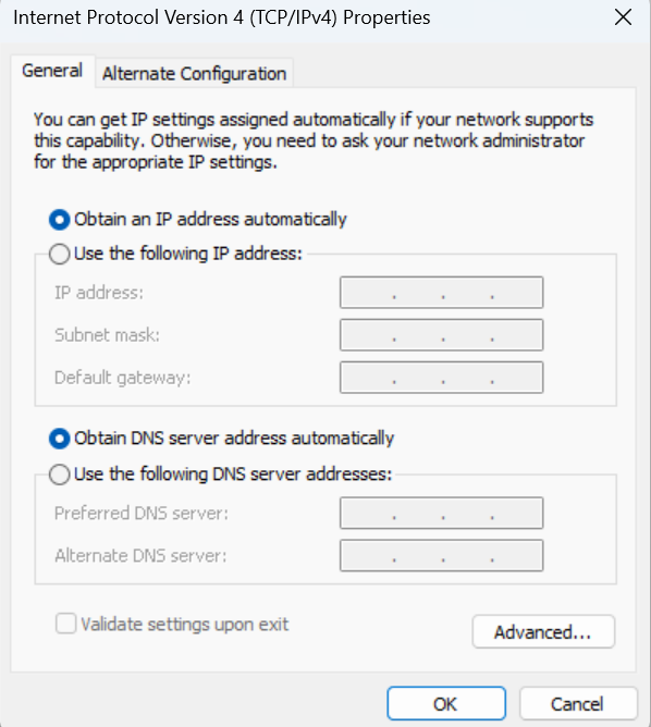

@philipdhedley what do you see when you look at the adapter properties
something like this ?
and if you then double click the IPV4 ?

These are my laptop, I compared them with my PC earlier and they were the same. I think the next screen was also the same. My PC is doing another chkdisk/r and it will be a while. I'll confirm as soon as its done.
