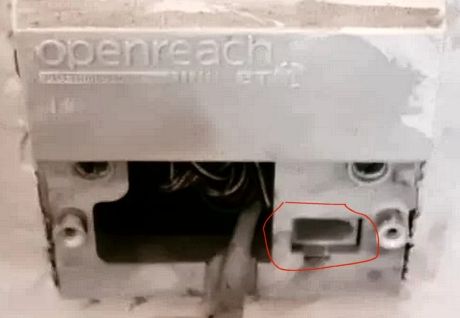

Oh, so the previous tenants just cut the wire - just outside the photo? It doesn't go anywhere? Where does the BT cable enter the house?

As said previosuly we need to see behind the front plate.
@bmc wrote:
When you remove both screws you should be able to ease the front plate off the box. It should only be plugged into what's known as the Test socket.
Whilst you can't see the rear of the faceplate (although apparently there's nothing connected to it), I think that's already been done, as shown in the photos @bmc
IDK if you noticed, but there are a series of photos at the link provided in the OP.

@RobPN Thanks for that - I hadn't noticed there were more, and they prove that isn't the Master Socket, which the OP needs to locate before we can get any further.

Thats right, I can promise you there's no wiring to the faceplate although not shown in the pictures. I've walked throughout the property to look for another socket and there's isn't one. The socket is also right next to the front door. I've tried to get open reach out and they're refusing. It's illegal for an electrician to touch open reaches wiring and plusnet can only provide an engineer if we are continuing to use them so in the mean time we have bodge wiring... yay...
I assume then, that is the master socket, but whoever put it in was either a very, very incompetent BT/OR engineer - or someone was messed around with it after it was installed.
Re: New House - Bizare Wiring - Master Socket - Cant figure it out
19-09-2021 8:10 AM
Which suggests that this is the master socket, fed underground directly.
In your second photo, wires can be seen at the back, which will be the incoming feed from the street.
With the faceplate on, the telephone plug would have inserted into the socket on the faceplate to feed another socket in the house, perhaps because the previous occupant didn't want to use the master by the front door.
If you can't see any other sockets in the house, maybe that cable will pull through - otherwise it can safely be cut off.
Have you tried a phone in the test socket?

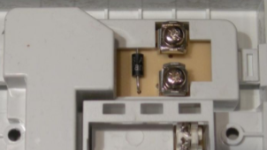

From what I can make out from this picture this plug has 8 wires which makes it a RJ45, RJ11 only has 6. In most case with a RJ11 only four wires are connected
Assuming the landline enters the building behind the phone socket it is a relatively simple job to check what can be disconnected. By removing the cover from the wall you should hopefully see, you might be advised to run a sharp knife around the cover to break paint/wall paper between the cover and wall.
The incoming landline is terminated to A and B (left picture the screws). Spare wires are often curled up and left in the box.
or
So it is safe to remove any other wires from the NTE other than the landline ones, if there are two or more wires connected to A and B just leave the landline connected. If you need to cut any wires do one wire at a time, this will prevent any short circuits occurring which could damage Openreach equipment.
It could be the last owner bypassed the front plate by connecting the modem directly to the incoming landline as a ADSL/VDSL does not require a filter unless a landline phone is being used.
If you remove the cover and not sure what you are looking at post a picture.
Hope this helps
Dan.
