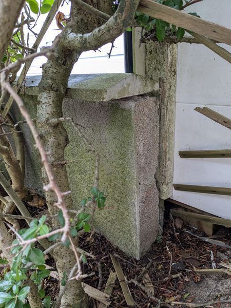

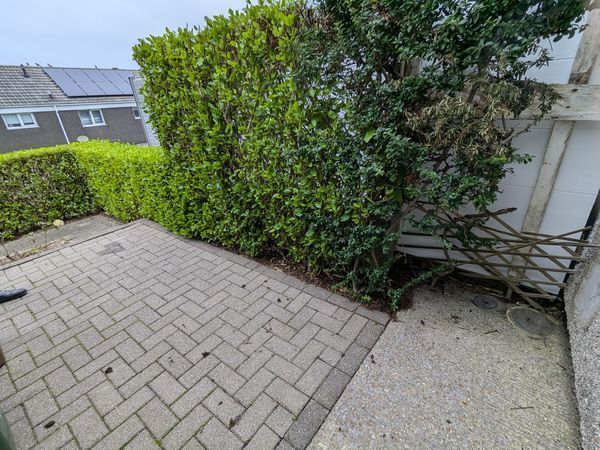

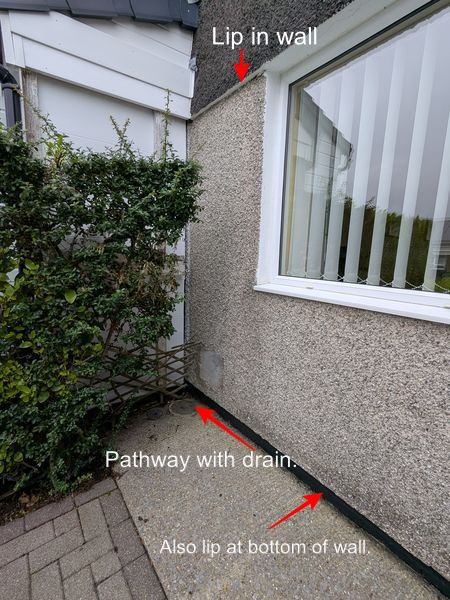

The queries I have are that the current copper wire cable comes into my house into the hallway with no socket nearby. It also is routed around the front of our next door neighbours' house so this isn't a convenient option. I would like the ONT to be in our top front bedroom where I have a desktop PC plugged into the router via ethernet, a NAS drive and my VOIP ATA.

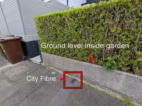

The entry point from the pavement isn't at ground level inside the garden and there's a well established hedge (40 years) all the way around the garden where we would want the cable routed. Then there's a path with a drain and a house wall which has a lip on it.
Is it possible to attach the beginning of the cable to the outer wall and run it to the corner or does it need to feed straight into the property?
The top window is where I want the cable to come into the house. The router sits on a shelf in the corner to the left of the window.
Can the cable come across the path or does it need to be up from the ground? We do not want to dig up the path, especially as drains run underneath. We could perhaps build a support to attach the cable to as it goes across the path.
The wall behind the hedge is ours so maybe the cable could be attached to the wall or laid underneath the front of the hedge. I would imagine there will be a lot of roots so digging down probably wouldn't be a good idea. We don't want to take up the brick paviours.

The main issue seems to be to get from the CF pavement access to the house wall,.where the junction box would be fitted. From there, getting up to the bedroom should be relatively simple - I would expect CF to run external fibre from that junction box and go through the wall to an ONT in the bedroom. I doubt the small lip on the wall will be significant issue.
To get from the pavement to the house wall is more problematic. I do not know if CF would run a  small duct up the external wall or would want to go through the wall just below pavement level and then up and across the paved area or round the edge of it. Possibly you could lay a duct for them to use across the garden to the house wall using an acceptable route ( I do not know where exactly the CF pavement access aligns with the garden paving/hedging). Nor do I know what diameter of duct would be needed but the mini ducts they used around here through the main ducts were only 8mm diameter and so a 30mm/40mm duct with appropriate radiused bends should be adequate.  But it all depends on what CF think. Perhaps others on these forums might know what is required.
Has anyone else nearby had a CF installation with similar issues? Is there an ongoing CF installation nearby where you could talk to one of their technicians?
If the existing OR feed also comes from underground, they would have similar problems assuming they do get round to building their network in your street - it might be in their "too difficult" category! If it is overhead then things would be much easier but you want to avoid having to attach cables to your neighbours property as that requires written permission. (wayleave).
Unfortunately, I do think you need to let CF visit to decide what they can do.

Thank you for your reply @jgb . As far as going through from the front to the back of the garden we were considering laying some ducting behind the hedge adjacent to the wall as long as we can get a clear run all the way through. Do you know what material should be used? Is plastic any good? The section in the front wall is probably going to be more of a challenge.
We saw City Fibre being installed the other day across the road so we asked one of the men to come and take a look. He was talking about digging up paviours and the pathway in front of the house where the drains are. Later that day my husband spoke to another CF chap who was sitting in his van so didn't see the property but he sounded more flexible. It's very difficult when you don't have the power to ask them out to take a look until the installation day.
We shall probably renew with Plusnet again this time on a SOGEA connection and place the landline on VOIP. If/when we spot the Openreach people in the street we may have a word with them to see what their thoughts are.
