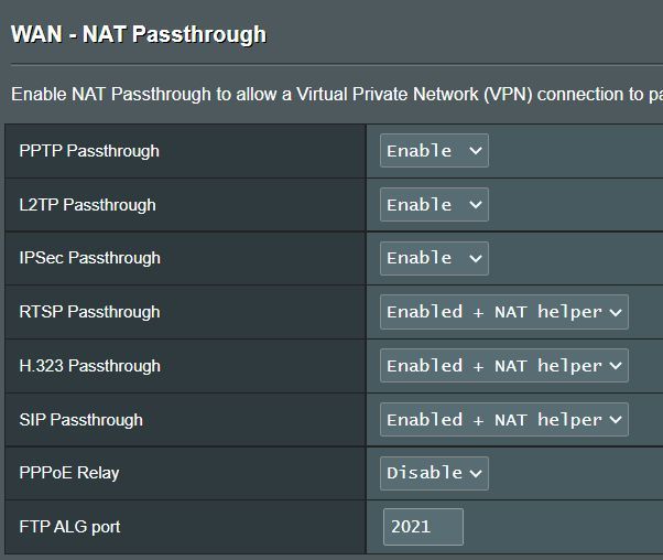

1) Would BT allow me to use my own router (An ASUS RT-AX88U) if I went for their service?
2) If so, I presume I'd still need to add the VLAN code 911 as the infrastructure has been laid by CityFibre?
3) I believe there are some other settings I would need to change if I wanted to use a VOIP service such as Sipgate?
4) Would I be able to move from Plusnet to BT without penalty?
I'm uploading the two pages from the router GUI that I think would require some changes in order to a) connect to the BT network and b) to enable VOIP to work. Apart from the usual user name and password, are there any additional settings I would need to connect to the service?ASUS Router Settings 2.jpgASUS Router Settings.jpg

@Brian_K
Can't answer all your questions but if BT are offering FTTP then it's over the OpenReach network and not CityFibre.
PlusNet are believed to be reading an FTTP offering with the next 3 months (with a new HubTwo moden/router). However until they make announcement it's just speculation.
PlusNet have been waiving charges for customers moving to BT / EE FTTP. You need to speak to the Customer Options team (don't have a phone number).
Do you already have a VOIP service? As far as I'm aware the BT offering includes a phone line (even if it's supplied over VOIP).

Re: I have a few questions about the upcoming FTTP
Im not sure on most of these im afraid.
You would be able to use your ASUS, you would just connect directly to the ONT they would install.
BT Do offer a VOIP Service, but you would have to use the BT SH2 that they supply in order to use it, you wont be able to have BT VOIP while using your ASUS
