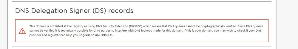

btw - I saw this at Nominet, whilst trawling for help. Can anyone advise on how to action this?

There is a nice overview of DNSSEC at The Internet Society
Basically, your top level domain must be signed (it will be if it is a .com or .co.uk, more obscure country codes may not be), and both your domain registrar and hosting provider must support DNSSEC.
With Freenetname, I doubt DNSNSEC is an option but someone else may be able to say for certain.
EDIT: Just to add that I wouldn't worry too much about DNSSEC for a small non-commercial domain - man in the middle attacks aren't common and require some effort, so a site with no commercial value isn't a likely target.

That is really helpful - mine is a .co.uk. - hoping this is a non issue. However, having been spooked I will investigate. Thanks again.
