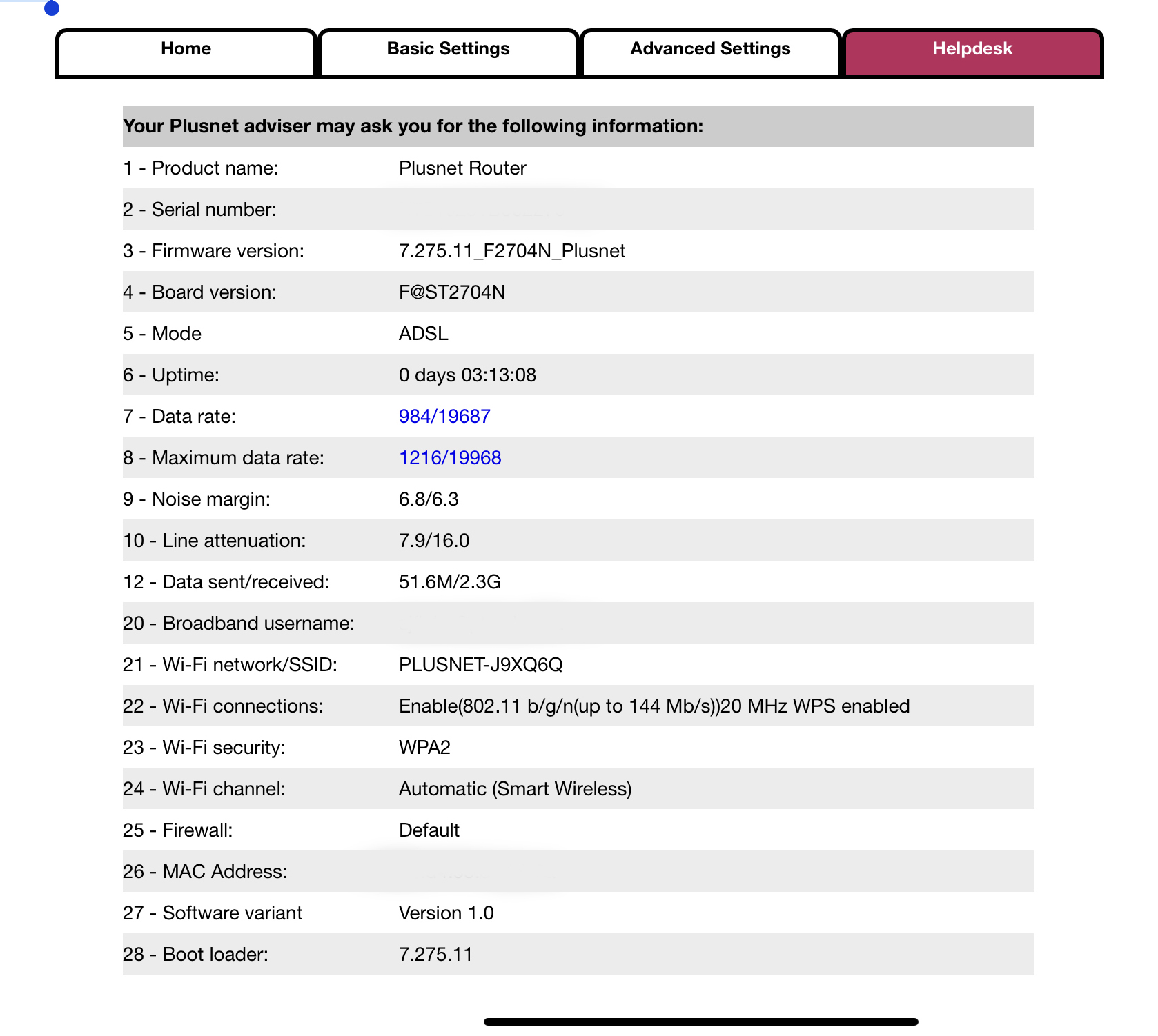

@sjf1965 Getting back to your current speed problem - as I asked in my initial reply: 'Can you post the results of the 'helpdesk' tab from your router - under the 'Troubleshooting' tab on the router homepage. Your observed D/S speed on that report says you are getting the best possible with an ADSL connection, but the U/S looks dire (and suspicious)
If you can do the above, we may be able to improve your current speeds a little until the Fibre swap happens (hopefully).

Re: Fibre here before - but not now?
11-05-2021 3:57 PM
OK - hopefully a picture will paint a thousand words. 😁
If you log into your router, you should end up with a page which looks like:-
If you click on the 'Troublshooting tab - top right - it should open a page with a heading which reads (in part) something like 'the agent may ask you for this information' - I'm paraphrasing, because I don't have that router - but it should give you a page with a load of figures, on about 24? lines. That is what I need to see, but please edit out any personally identifiable details like your username, the router serial number and suchlike.
If I can see that, it will give me an idea what may be causing your slow speeds, compared to those shown on the first screenshot you posted - now deleted, but I have saved a copy.😉
11-05-2021 4:37 PM - edited 11-05-2021 4:50 PM
Here you go.
