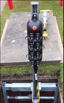

If no duct is available to OR they would dig a new trench. Something similar to the following would be installed in the nearest underground cabinet to your property.
