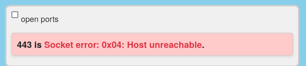

For me and I expect others when I attempt to connect to https://secure.nsandi.com using a browser netstat reports
TCP 192.168.10.100:55970 157.203.60.156:443 SYN_SENT
This SYN_SENT error is inline with a routing issues or possibly a firewall but unlikely. BT group having many IP Address ranges, some may work and others may not that's the nature of a complex network.
You can prove if a connection is possible using this link https://onlinechecker.net/
I see 443 is Socket error: timed out when using my public IP Address
For now if you are not employing a personal VPN client then I suggest using Opera browser as that has a free VPN as part of the product, some other free VPN client or as I have Hotspot from my smart phone.
