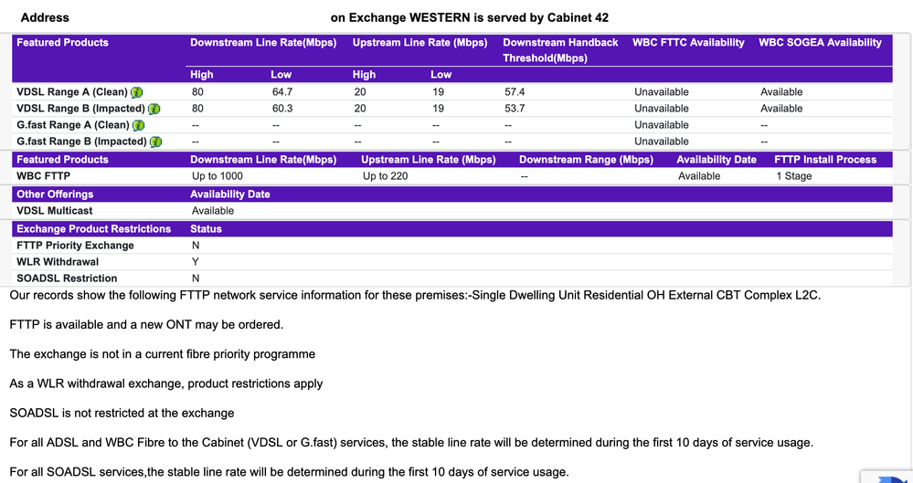

This link https://www.broadbandchecker.btwholesale.com/#/ADSL/AddressHome provides an overview of what services are available to the property.
The narrative at the bottom should indicate if a Openreach ONT is already installed
Take a screen shot of the page if you require any help

Hi, all - thanks so much for your responses! So if I'm understanding correctly, the property definitely has full fibre currently, but depending on what network TalkTalk is using in my area (if it's not the Openreach network shared by Plusnet), I'll require a new install...
I suppose it's hardly the end of the world if that is the case, but I'd rather not wait in for an engineer appointment and have extra holes drilled in my walls if it turns out it's not necessary.
I checked my address using https://www.broadbandchecker.btwholesale.com/#/ADSL/AddressHome as @Dan_the_Van recommended, and these were the results - unfortunately, I'm rather at a loss as to what any of this means. 😅 You've all already been very helpful, but is there any chance someone could have a look at this and see whether it indicates if Openreach fibre is currently in place?
