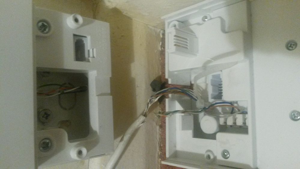

Some photos would help.

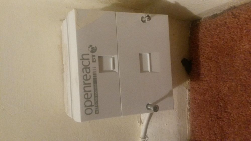

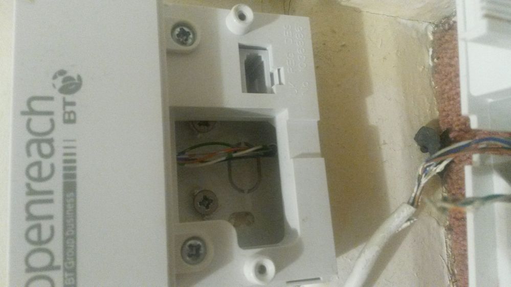

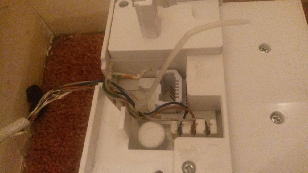

There you go, does that help?
that is the master, is it good to go then?

Yes. The extension wiring does not need removing.

@Baldrick1,
How do you draw that conclusion?
It looks as though there are 3 wires connected to the extension face plate. If that’s correct then the bell wire is connected which can degrade the broadband signal even if
The colours of the wires in the extension cable are not clear, but they do not look like twisted pair wires - again not ideal for optimal broadband performance.
If the above is correct and the extension is not required, removing it removes a potential for degrading the broadband signal.

Hi
so there is one plate on the wall, the cable from the wall runs into it. Then, the faceplate is connected to the "backplate" not via cable, but via the phone plug itself. Then, in the back of the faceplate, is the connector which you can see in the fotos, this is where the extension is connected, and yes these are 3 wires connected, a blue, orange and a greyish or white one.
Now, we have our telephone connected to that extension, is that going to be a problem? I would like to keep the extension for that reason. Or does this impede braodband too much? Or will removing this "bell wire" solve that issue?
