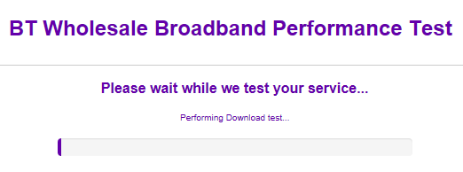

@Gandalf wrote: Our suppliers believe this to be fixed.
Hmm, tried at 20:34 and after 2-3mins of this:
It gave a rather low result, so further diagnostics gave:
an unusually long wait and:
but that could just be me.....? Upload is up a little, but not where it can be.
