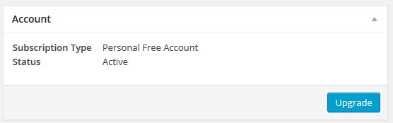

Where does it say that? I've just accessed the Askimet settings page on a Wordpress blog I have installed and I see this:
Are you running the latest versions of Wordpress/Askimet?
