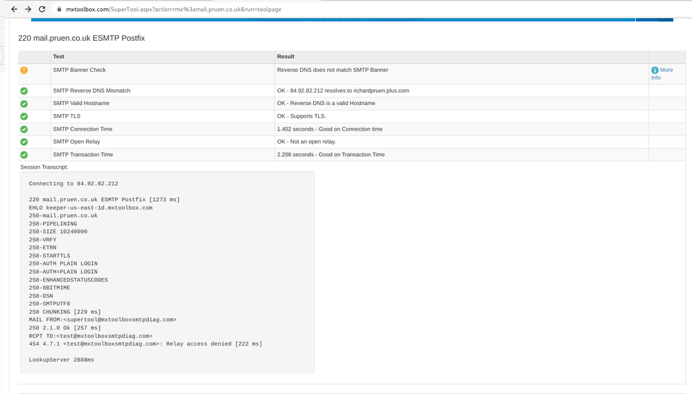

Postfix seems to be ok, see the Transcript below, and also open relay check (not an open relay): Screenshot from 2023-02-04 17-19-24.png

If blocked for supposed spam, then can I have some examples, please? If it has happened then I would like to verify the DKIM signatures and source. A quick check for compromised machines shows nothing out of the ordinary, and no tripwires have been triggered. I am in the process of verifying files against hashes to make sure nothing has been tampered with.
